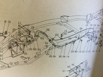

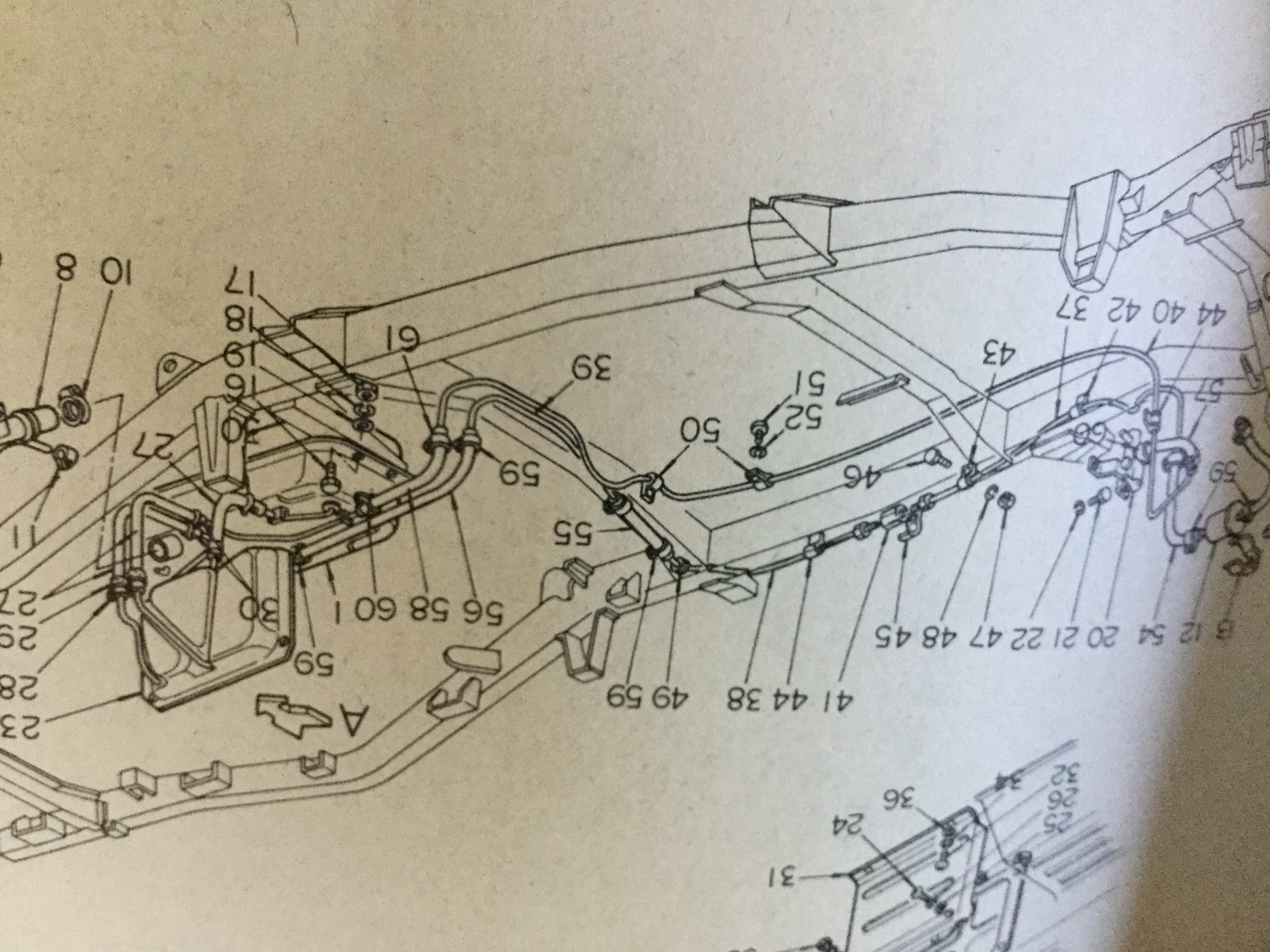

PostPosted: Mon Aug 07, 2017 5:42 pm
Straight out of the parts manual

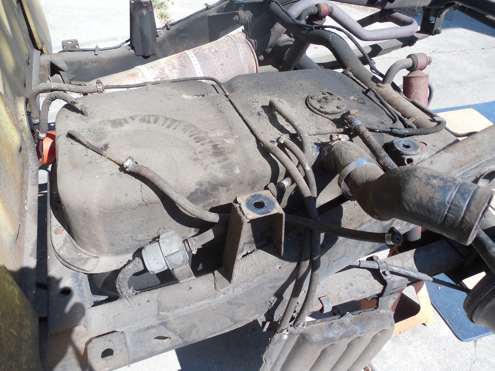

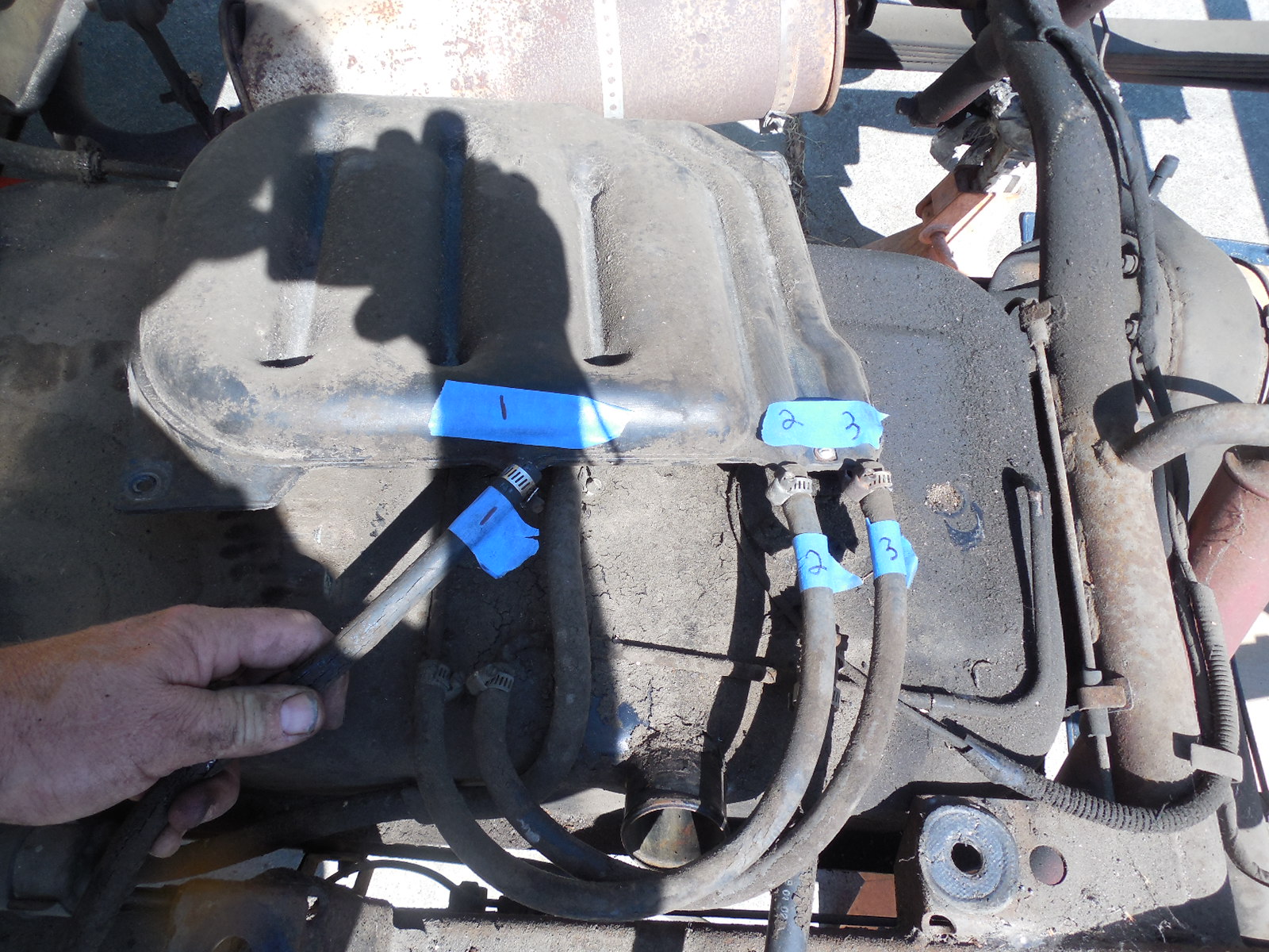

PostPosted: Sat Aug 12, 2017 10:43 am
Posts: 607
here's a couple of the gas tank lines on my 77 the way i think they go. BUT using the manual is the best way to be sure .
