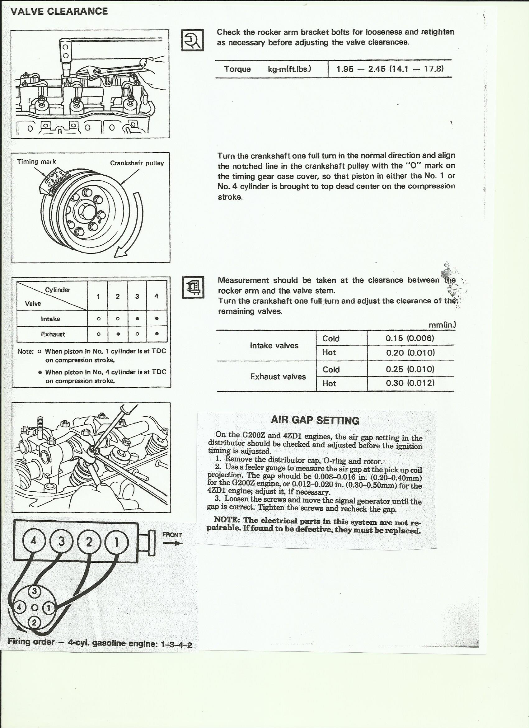

For a 4 cyl do it like this:

Ok thanks I got it handled! My head needed a retorque after 25k miles so I'm glad that I did this. I was a bit confused by the schematic above so I'll just write this for the next guy:
Line up the timing mark with 0 on the indicator. If #1 is rocking, both intake and exhaust are loose and close to .006 and .010, then adjust #1 intake, exhaust, then intake on #2 and exhaust on #3. If #4 is rocking, then do exh on 2, int on 3, and both on 4. Then turn one full rotation and you can do whichever 4 valves you didnt just do.
