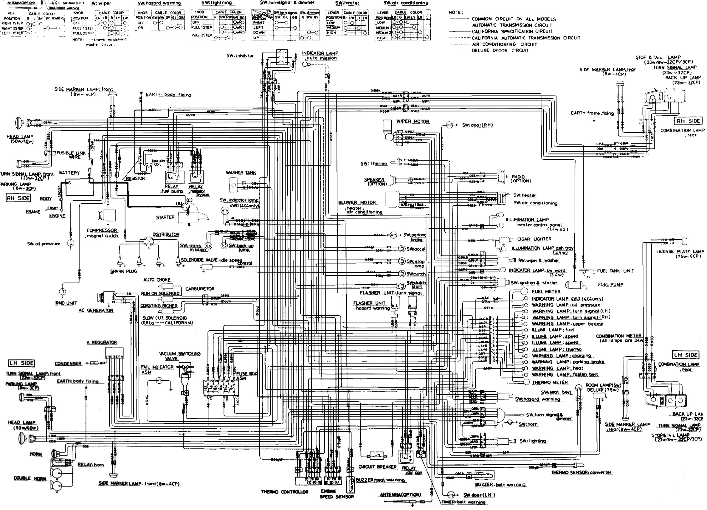

Headlight wiring is a little difficult to trace without a diagram. I've attached a schematic for the 1980 LUV if that helps.
