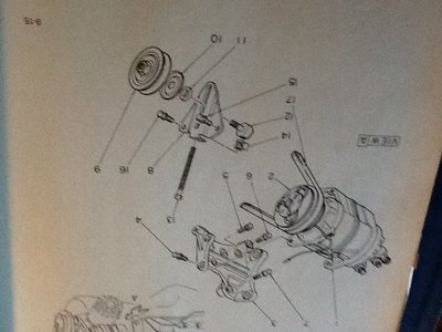

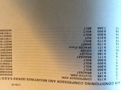

Does anyone have a book that has a picture of the idler pulley assembly that puts tension on the A/C drive belt? I have been searching for one for months and can't find anything on it. Am I calling it the wrong thing? Is there a part that cross references? Thanks for any help!
PostPosted: Wed Sep 03, 2014 7:01 pm
Here you go.

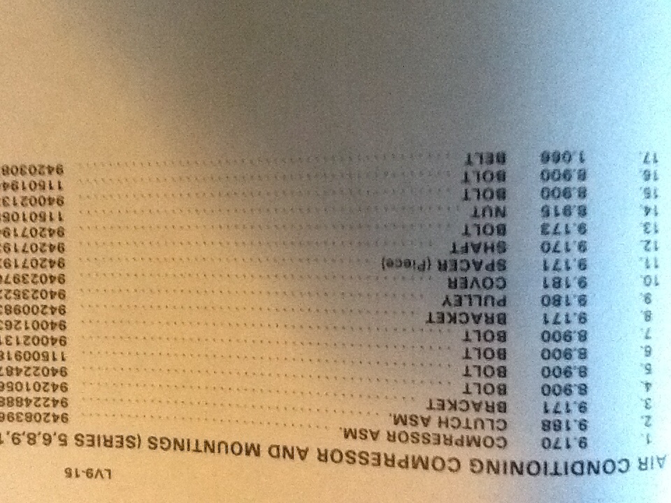

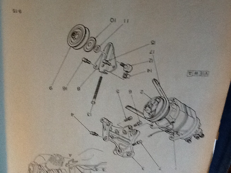

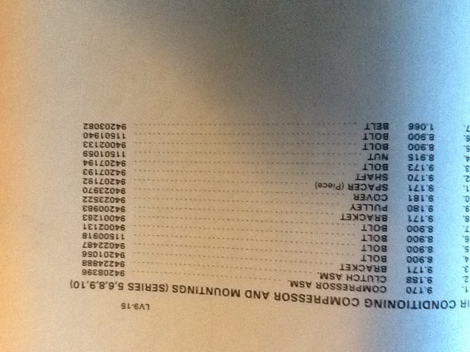

PostPosted: Wed Sep 03, 2014 7:02 pm
Better part numbers
