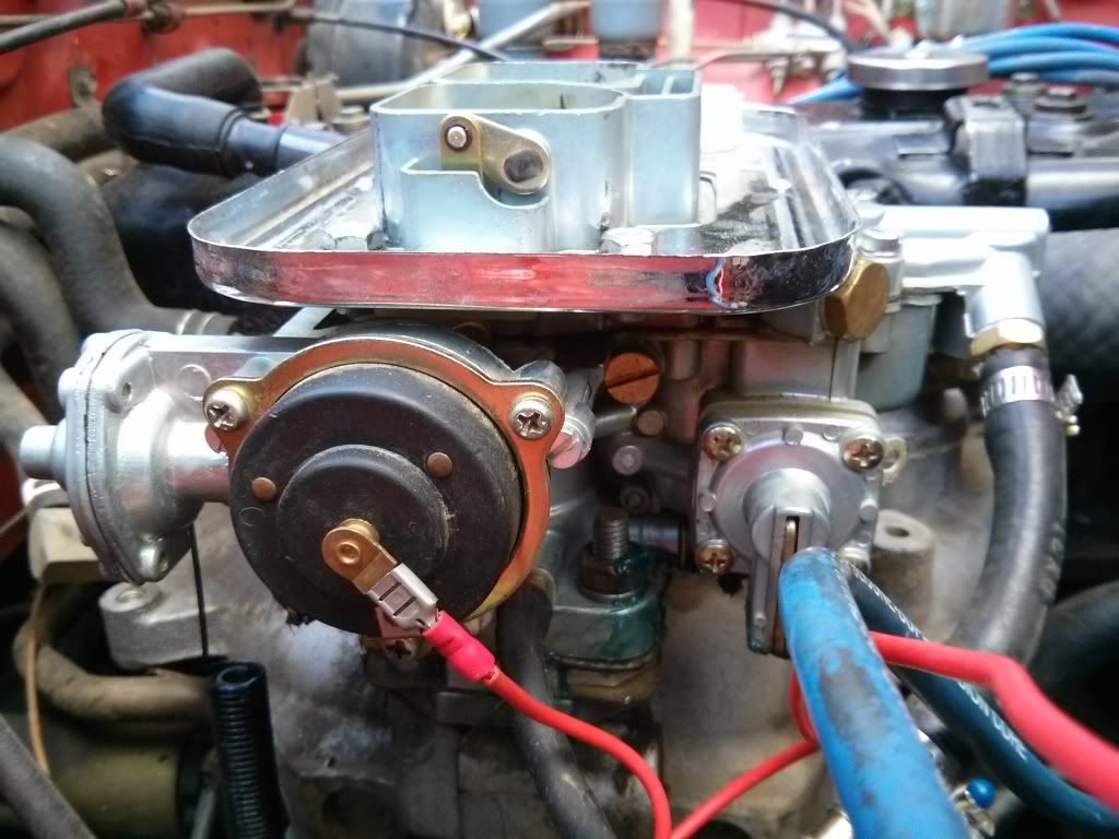

Does gen light turn off after starting engine and revving it up a little? If it does then generator is working. The electrical idle circuit may be malfunctioning causing the no idle issue. Idle solenoid is located under the air filter housing on carb next to the accelerator pump arm. It has a single wire coming off of it. Check for 12 volts on that wire while engine is running. If no voltage is found that is your problem. Let us know what you find out.

As for that idle solenoid ... I have a weber carb and am not seeing it anywhere?
