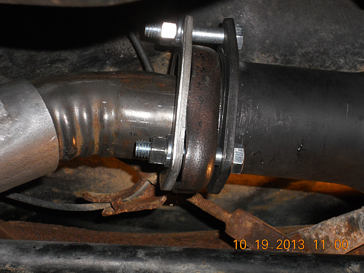

The PACESETTER HEADER is another story. I guess between the Long bed and the Four Wheel Drive the " It WILL FIT YOUR VEHICLE" Ad is a LARGE STRETCH. What does ONE do about the E-BRAKE bracket? Do I bend the arm a bit to fit past the header? Can I relocate it? I have thought about making a few measurements and head to a junk yard and find suitable E-Brake hardware that would locate it to the middle away from header. Use one that has a small handle and mount it next to the 'HUMP". REALLY, what are YOU GUYS doing about the "FIT issues?
Oh and the header installed was 1/8" away from the floor board directly behind the gas peddle. that took about four hour to button up. And the CROSS MEMBER. Mine ended up about six inches from the collector. I used a turn down, cut off the exhaust manifold off a 1987 JEEP CJ7 to get by and under the CM
I used a METAL FELPRO and a FIBER PACESETTER GASKET and I ended up , just barely slipping by the CLUTCH ARM

Just a few more.
