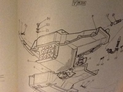

A/c was a factory option. The expansion valve is behind the black box in the cab on the passenger side, where the evaporator is. It's between the plastic box and the firewall. GM part number 94023480. See item 5 in the photo.
Strange, I found the part but it says it's for a Volvo.
http://www.oehq.com/oeparts_94023480.htm
thank u just what i though got to tear truck apart to get it
