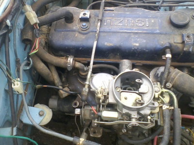

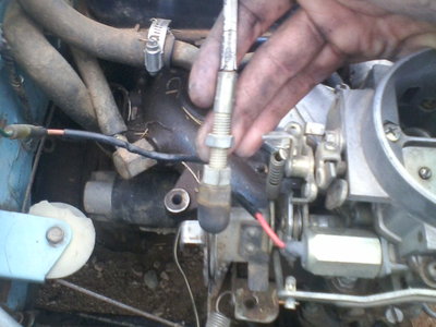

In the pictures attached is showing what is missing (no not the air cleaner and dish, I have that)
I need the piece that allows the throttle cable to work and makes idle possible (can't think of the name of it... Throttle cable bracket?) I might be able to rig something up but would prefer the right piece.
Does anyone have one or know where I can pick one up ? Auto Parts stores and RockAuto don't seem to have one.
If you have one, PM me a price + shipping to Southern Arizona, 85615. Paypal ready.

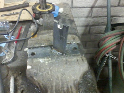

Something like this right?
Had some metal strap laying around so I threw something together. It was a quickie but it will do until I find the proper piece.
Still would be interested in the correct throttle cable bracket! Shipped to 85615!!!

The bracket you are looking for is usually bolted to the carb itself, not the intake. Here is one pic I dug up on Google:
http://www.justanswer.com/uploads/rickr ... rb_006.jpg
It shows the bracket on the right that also holds a vac diaphragm that is part of the secondary linkage I believe. Looks like you are missing that too.
I also found a carb on ebay with somewhat decent pics:
http://www.ebay.com/itm/111093890042
One of the pics has a pretty clear view of the bracket and the vac part.
Keep in mind that the LUV carbs did change a little over the years. Some of the 76 and 77 carbs I have actually have a couple of vac diaphragms in that area instead of just one. Main point is though that you are missing more than just that bracket. I'm not sure if you are going to see the secondary open up at all on that carb or whether that missing part is more involved in the choke and not the secondary. No secondary working means that truck will have even less power than normal, which isn't a huge amount already.

Oh yeah, I also found this post here searching for "carb linkage": viewtopic.php?f=5&t=27274
In the second and third pics you can clearly see the bracket, there is a black wire laying in the hole where the throttle cable should be bolted into.

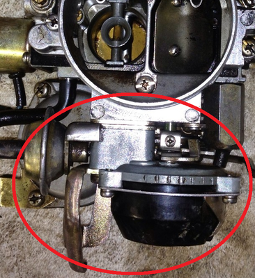

Actually the missing diaphram is the choke pulloff unit. The large flat horizontal one is the one that operates the secondary. Pull off diaphram's job is to pull open the choke slightly when the engine starts to keep the mixture correct and not flood out the engine until it warms up.
Yes I remember now, thanks egg. I had one of them on my 76 split right down the middle and I JB welded it back together. As I recall before I got it repaired I backed the choke off a bit but it was starting and running ok without it, as long as the vac line leading to it is plugged. It is one of the very few things that the stock Hitachi carb tolerates being unhooked or disabled. :lol:

Oh okay, I see what is missing! I'm missing the entire choke pull off unit! The vacuum nipple that the hose attaches to has been capped off. I've looked all over the inside of the truck and in the bed and the part isn't there.
Attached are pictures.
So the name of what I need is the choke pull off unit ? Choke assembly?
