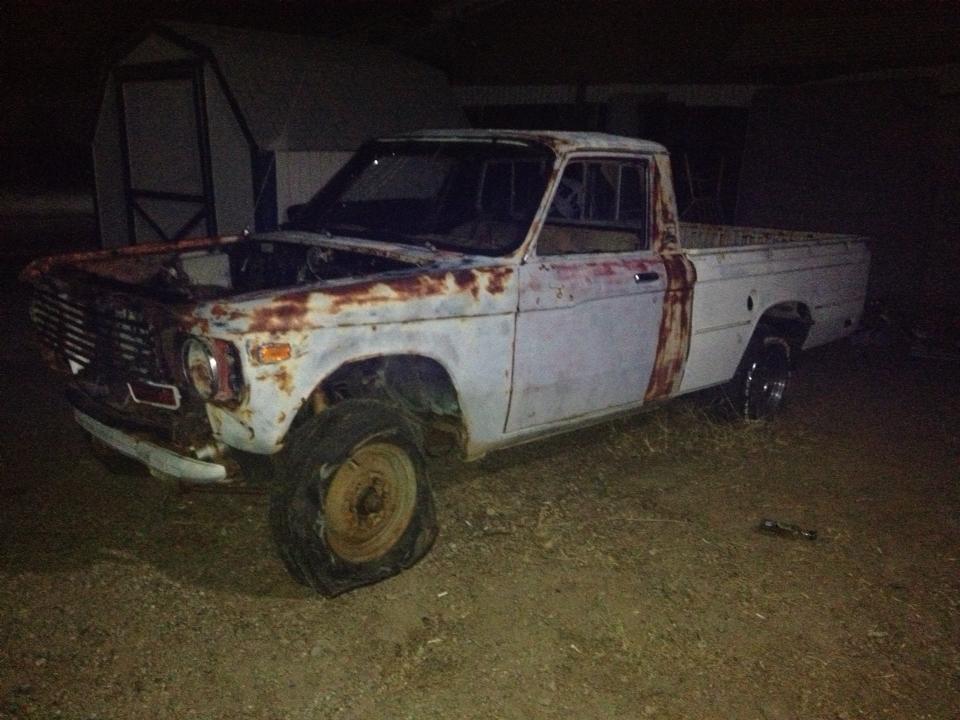

heres some pictures of the truck i figured id post

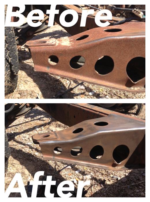

started some clean up
