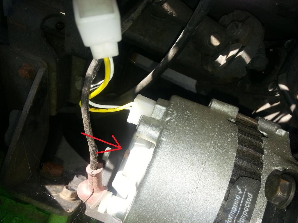

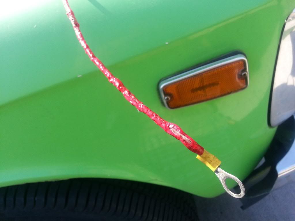

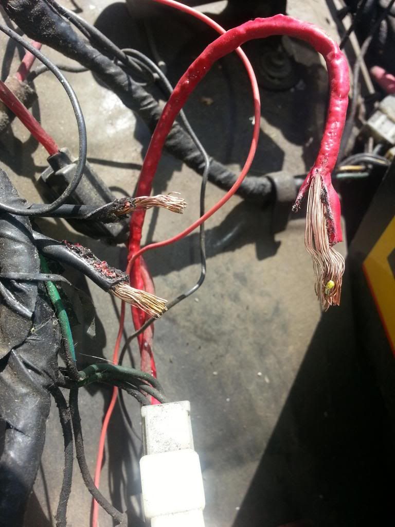

I looked at the fuel filter today and it's nasty looking. I'll replace that. But man, oh man, I've got some pictures to post here in a second with what happened today. I went out, jumped it with my car, but tried starting it right away, and smoke started coming from positive terminal, and it melted the wire that I'm assuming is the "main" power wire, because without it being connected, nothing works. Not the larger positive cable. I disconnected it, let the battery charge up, then reconnected the wire (melted and all...like an idiot. i know ;-) ) and it started up fine, no smoke, no noises, but now it just won't stay on. It immediately dies. So I'm wondering if maybe the new alternator got fried in the process, my tach doesn't work either, along with the fried stereo. Lights work, running lights, and if I keep my foot on the gas, I can turn on the lights and there's no longer any flickering. I'm going to replace this wire today, and am wondering if there's any specific gauge I need to be getting? I also bought a 700 cold cranking amp battery a few years ago and I think I'm going to replace it with a suggestion someone said of a 1000 cold cranking amp.
Pictures in a second..
this is where the red wire was spliced into the 2 black ones. they fused together after the smoke..
had some smoke coming from the connector
and this is the result. the cable melted.

I think you have what those certified sparksitrician folks would call a SHORT.
If the fat wire at the alternator is melted then you probably have more problems buried in the harness. That wire runs from the alt, to the fusebox, to the firewall, into the cab, back out to the firewall, across the firewall to the passenger side, and up the inner fender to the battery. It is running that whole way along with a whole bunch of other wires that really don't want to be connected to that one.
My suggestion, buy a few rolls of black electrical tape (unless someone has a good link for wire harness wrap, non adhesive aka dry vinyl tape if you can find it). Start at the alternator and unwrap the harness and follow that big wire. Only unwrap what you have to. You will find some places no doubt that it has melted the insulation off, and melted to some other wire. You will have to get under the dash, I recommend pulling out the gauges. (three wing nuts on the back, one at each corner on the left and one in the middle on the right) Replace that large wire the whole way and look for any other wires that got melted too. Wrap them with electrical tape before rewrapping the rest of the harness. (unless they are really bad, you could replace them too but try to keep the ends that show as the stock wire to match the wiring diagram) Once you have that wire all the way replaced and following the original path and potential shorts covered up then you should find your problems fixed and you can rewrap that harness.
It took me most of a day to do this on my 79, but half of that was trying to find ways around having to tear it all apart and break that stock harness wrap look. The end result was the short was fixed and about a dozen intermittent electrical gremlins were fixed at the same time.

Ground at the Alt?? That fat wire held on by a nut is positive, hot right to the battery positive terminal. If it was loose and touched anything metal that would have been your short. Glad it is identified. Having a mysterious short to ground in that wire can drive you crazy, everything works until it randomly shorts and you get a smoke show.
There's a total of 3 wires on mine, one is that fat wire held by a nut, than the connecting plug or w/e it is, and a smaller wire. Whatever it was, as soon as it was connected, the thing has no problem. Maybe that was the reason why my battery wouldn't stay charged...? haha
In my picture you can't see that other bolt on the alternator tho.
PostPosted: Fri May 10, 2013 7:28 pm
you can barely see it in the pic, the main one is the + to the battery, the other 2 in the shared plug are for the charge "idiot" light and the individual black wire on the case is the ground
