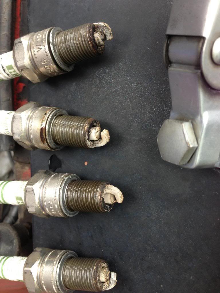

After the new gas, the problems came back. I put STP octane booster in and it didn't help.
So I was going to install an old MSD box I got laying around and I decided to check the plugs first and here is what I found
So I cleaned em up and I'll go run around and see how they do.
PostPosted: Sat Apr 20, 2013 12:57 pm
Posts: 207
Location: Seattle
Ya it works fine now. Back to Arco gas and time to recheck timing and idle mix.
Do those plugs indicate anything in particular?
