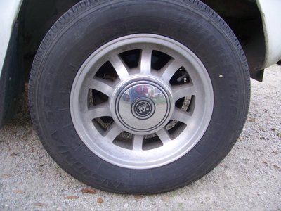

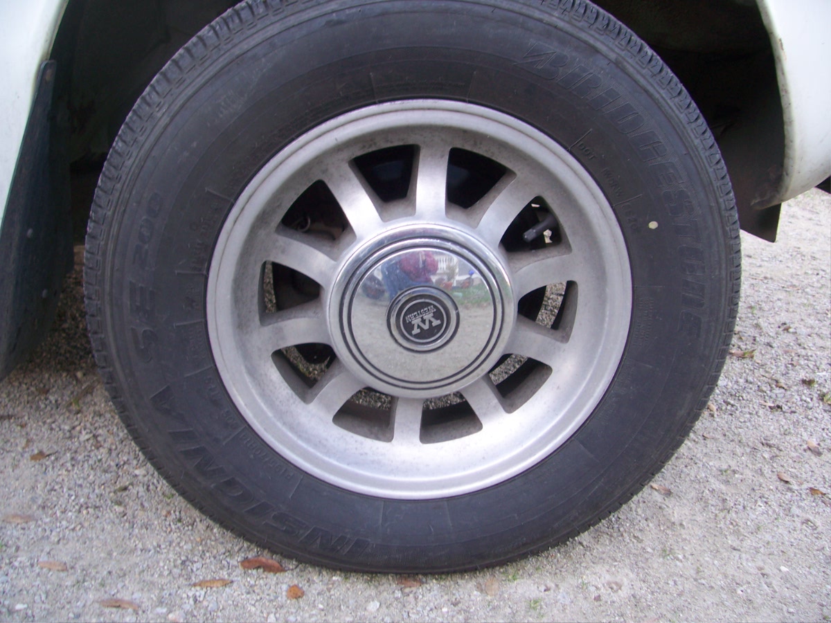

Posts: 143
These are Western Bullets. 14" x 6" with 195/70 R 14 tires.
Bought them in about 82 after I wore out the original tires.
Sometimes you will see them with a smooth hubcap.
Kind of a hassle to take them on and off because the lug nuts fit inside a counter bore instead of having a taper.
Wanted to bump the topic because its nice to see what others are running.
