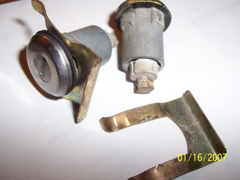

I did buy new door locks and installed them on my LUV. I can tell you for sure they are interchangeable. There wasn't any designation for left or right on the locks, and the lever on the inside removes with a snap ring so it's just a matter of flipping the lever over. I even have photos! The main concern I would have is that the lock cylinder fit tight in the door, and not turn. I hope I never have to change these locks again, as you can see from the indentation in the door it was a tight fit. I also took a photo today of the old lock cylinders.
I ordered the new ones from RockAuto.com. It was Part#DD1 D571A, but notice it was black powder-coated. I think they also have chrome.

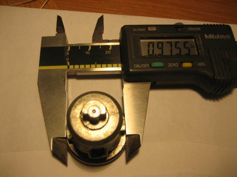

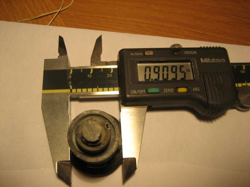

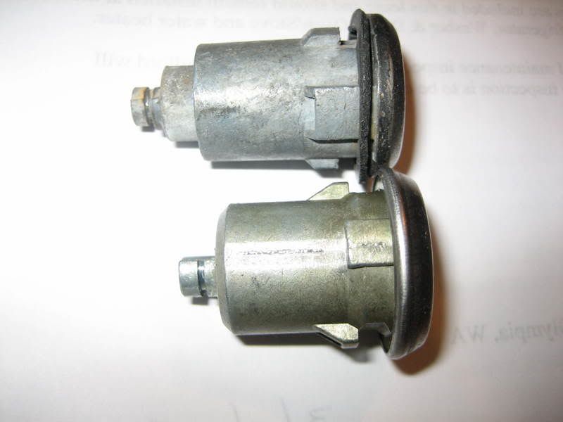

does anyone with a parts book have the original Part number on these locks. It seems that most of the auto parts stores around me have the wrong part called out.
FullaLuv
do you have a picture of the D571A you bought form rock Auto before you installed it? Do you remember if it was the same length as the one your replaced? All the ones that I am finding are to short and don't fit in the door hole.
Current Fleet
pics
PostPosted: Wed Jan 17, 2007 10:55 am
Posts: 177
Location: Olympia, WA
Hi john,
I think this might be the reason why you had problems getting your replacement locks to fit. It seems that all the parts stores are calling out are to big for the hole in the door
Stock
replacements
Current Fleet
pics

Everyone claims to have them but it looks to me that all the auto parts stores are calling for the lock that is too short and does not fit in the hole as shown above. Even rock autos. Fulla luv dented his doors because of the locks from rock auto were too big for the hole in the door.
see the pictures above.
I am hoping one of the guys that have a parts book can look up the original part number for me and a can bake track form there.

I just got here today, and hadn't known this discussion was going on. So I just want to say the "dents" that I put in the doors are acceptable. I considered it a tight fit. Like I said I wouldn't want to have to take them out!! I realize now I should have given some support to the inside of the door with perhaps a large deep well socket that was larger than the hole. You could also take a round file and evenly remove just a little of the sheet metal and keep trying the lock until it fits. Maybe I could try to pop it back out later, but it doesn't hardly look that bad to me. The shorter length lock cylinder is not a critical factor, as the rod will still reach the lock cylinder. I would recommend getting them from RockAuto if you want new ones, and when you go to a wrecking yard and buy it used it's just like a box of chocolates.
