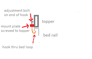

PostPosted: Wed Jan 16, 2013 5:13 pm
i was picturing it like this
if you used the hooks you see used up in rafters you could find a nut that would go on it :lol:
or maybe bend and thread a few toedown hooks
