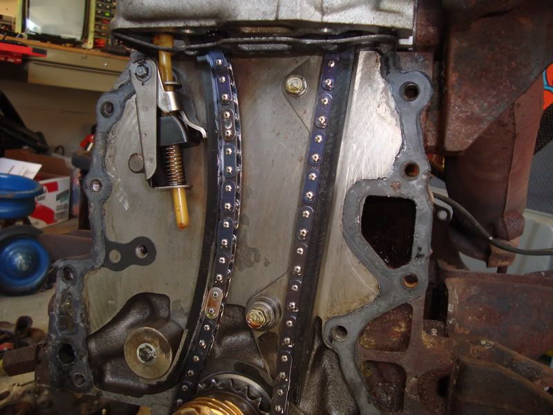

howdy new to this site but finaly found people into chevy luvs like me. anyway i got a question regarding timing chain tentioners. i have an 80 luv 4x4 and i currently replacing the timing chain. i have done a cuple but this one really stumps me as the tentioner is totaly different than what ive run into before. the ones im used to are small and spring loaded with a plastic lock like a screw. the one i have on my block is a cast peice that bolts onto the front of the block and is much bigger and built differently. my question is can i run the new tentioner was this some sort of desine change? its been a while since i did one and dont really remember how it goes on but with the one i got it would only be held on by the top peg wich an e clip

If you can post a picture it would help. Here's what my '79 looks like

hey thanks alot ur picture basicly ansered my question was just wondering if it will work and it will now the only other question i have is were can i get the oil sqirter jet? the little washer thing on the lower guide bolt my timing chain grinded mine in half is it avalble anywere new? might have a junk motor i can pull one off of but dont know yet
