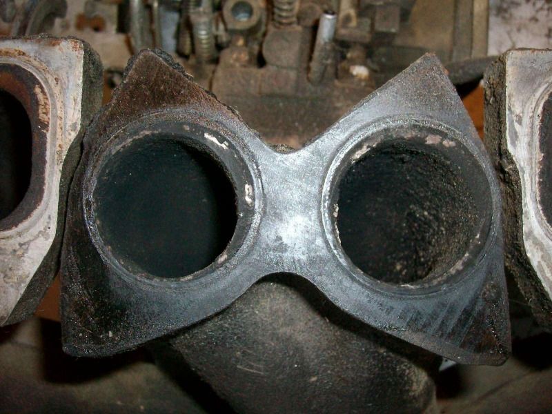

What I needed:
Series 4-5 exhaust manifold - drivers side, engaged with the intake manifold and carb.
[marked #6]
Notice the intake port on top. That is the critical difference between early and late-series manifold designs.

What I accidentally bought
Series 6-8 exhaust manifold - passenger side, opposite of intake manifold
[marked #17]
Notice that there is no longer an intake port, since the intake manifold and carb now live on the passenger side of the engine.
As I mentioned above, the one from Indiana was incorrectly labeled, and I was too inexperienced with the variations to differentiate them visually.
It seems obvious in retrospect, but it is not apparent if one is unfamiliar with the global changes made after the Series 4 model.

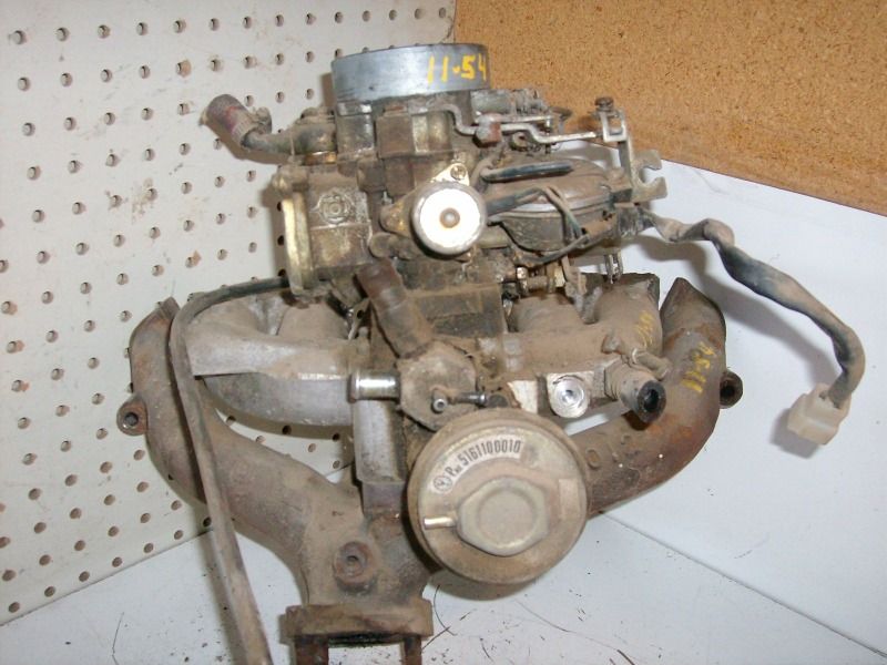

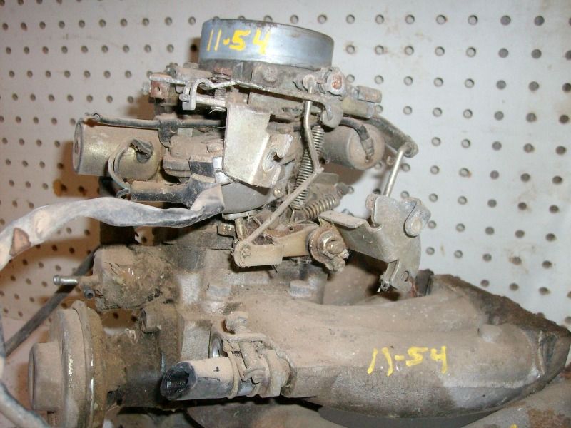

I asked the polite-but-impatient in-house yard monkeys to get cranking, based upon the following duo of disorienting images sent the previous day.
Both images are taken from the drivers side of the engine compartment. The valve cover is barely visible at the top of each image.
It took a little faith and a lot of presumption to claim victory at this point, but there was light at the end of the tunnel. That bolt spanning awkwardly
between the two manifolds near the center of the first image was the clue I needed!

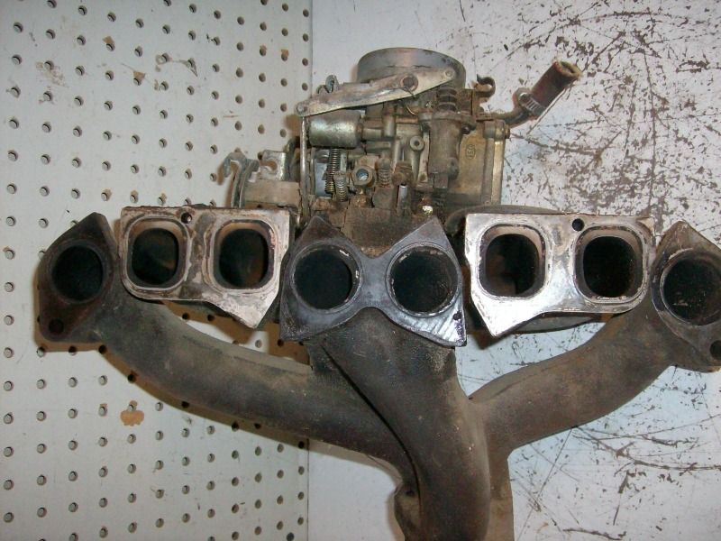

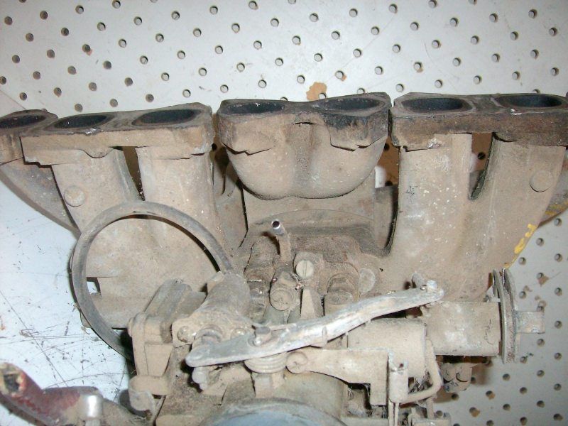

In the interest of confining my inevitable 'next part search' to my own shop shelves, and since it's easier to pull the exhaust/intake/carb as one assembly,
I asked what they'd want for the whole top-end, minus the head, along with a couple of other goodies 8)
Here's what came out of it:
Does anybody see any red flags? I haven't done this enough times to be able to quickly see issues would be obvious to the more experienced among us.
It's on its way now, so I won't know for a few more days whether there are any surprises. The carb looks like shit, but it's just for parts anyhow. They sprayed
the interior of the manifolds and claim they didn't notice any seepage to the outside, but with it all bolted together, who knows what could be hiding.
Fingers crossed for no well-hidden cracks.
I imagine I should probably resurface the faces which mount to the head, but I don't know if it's absolutely necessary.

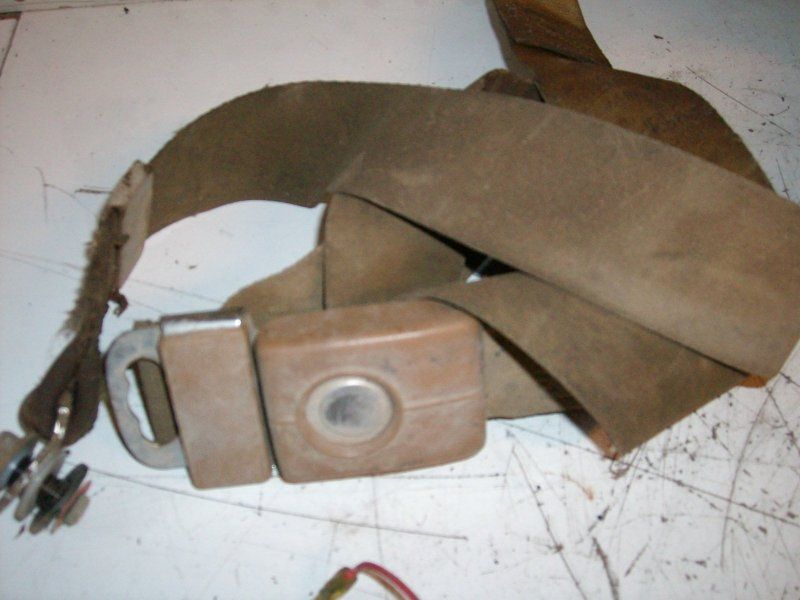

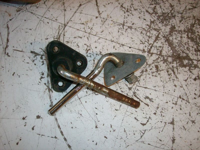

Bonus parts!
Matching belt and buckle for center seatbelt installation
Visor brackets - mine are sun-toasted to a crisp, and I'm just waiting for one to snap off. Now I'm equipped with a duo
of marginally-less-crispy replacements.

PostPosted: Wed May 09, 2012 10:06 pm
Posts: 550
Location: Redfield SD
Be safe and take it to a machine shop to check it with a straight edge before you install it.They can through it on a broach or a mill to clean it up.DO NOT let them use a sander...Very inaccurate and shoddy!
PostPosted: Fri May 11, 2012 12:45 am
Posts: 313
Location: Los Angeles, CA
Will do.
