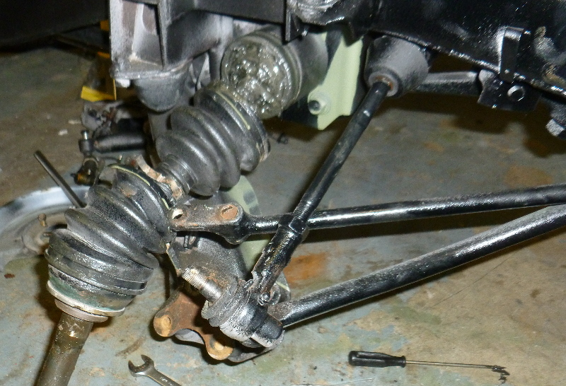

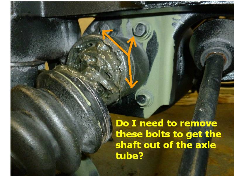

Ok, so I'm hip deep into this deal. I have dissasembled most of the two front corners and am down to removing the axle shafts. I removed the inner boot but can't free the shaft from the housing, it slides in and out a few inches them stops short of coming out. I don't want to force it or screw anything important up so I stopped and need some advice. I see the 4 bolts that APPEAR to hold a plate that may be the issue? If I remove them should the axle come out?
I have all new parts to replace the works, Inner/outer tue rods, upper/lower ball joints, upper A-arm shafts. all seals and bushings, shocks, brakes, new rubber for all the links, etc. so need it or not I'm doing it all, any tips on any aspect will be greatly appreciated, I don't have a shop manual, just relying on my mechanics instinct to get me through it :ebiggrin

On a Trooper you have to drop the entire front axle assembly out onto the ground, not sure about a pickup but I suspect they are the same. At least go buy a Haynes/Chilton manual, not as good as a shop manual but it should be a big help.

Ok, I can drop the axle to the ground, question though, why would that be required? It doesn't appear that being bolted to the frame has anything to do with the axle comming out of the tube? I plan to buy a manual but all the stores with one are closed around here today. Anyone have a minute to look in thiers to offer some instruction or confirm the drop the entire axle out deal?

It's been awhile since I done mine but I think there's a lock ring in there in the housing and be sure you keep turning the CV shaft while you put pressure on it, I could be wrong about the lock ring it's been awhile since I've redone mine just take a pick and run around the edge and if it's there you'll feel it. I'll take alook in my book and get back to you.

Thank you for looking in your book! I fished around for a lock ring but so far no cigar. I'll tell you one thing, these little trucks are built like tanks! I can't believe how much stuff you have to unbolt to do simple R&R jobs! Dang bolts are murder to get loose (upper control arms!) 8O

In the Trooper book it shows a snap ring right at the edge of the housing on the inside, hope that helps.

Ok, I'll wipe all the grease away and see what i find. I did locate a Chiltons that was hidden in my truck! problem is that in the step by step axle removal it basically tells you to drop and drain the entire axle assembly but gets very vague about the actual process of removing the shafts so not much help, funny though, thier illustration looks almost identical to my picture above, everything appart, but the axle still connected to the housing, no further instruction.

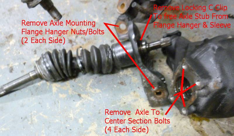

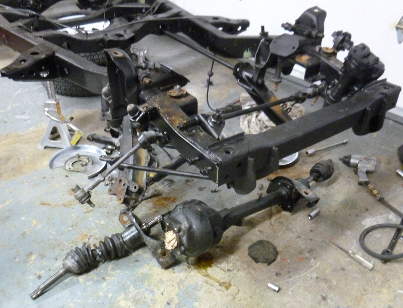

Ok, here it is for the next guy who finds himself in my shoes someday.
To change the axle shafts and or the CV boots you do need to drop the entire front axle assembly. Furthermore, you should also remove pretty much the entire front suspension as well because most of it will either make the job impossible, or much more time consuming in struggling to get the axle assembly in and out (this includes the lower control arms and torsion bars). I wrestled it out leaving the LCA's in place but it took some struggling getting it around all the remaining parts in the way, I have a feeling getting it back in will be no picnic.
Here are the pics that Chiltons left out, (probably because the first pic would scare off most anyone wanting to do the job at home!) :lol:
There is a C-clip around the axle stub that is enclosed inside the center section when the axle mount is bolted to the truck, there's no way to access it without dropping the axle tube & center section down and pulling off the axle tube mount/hanger/flange deals.

Good write up, When I changed my front diff years ago to get 4.56 gears in my old 80 luv I did have to drop the whole thing to get the cv's out of a trooper but can't remember having to drop the front on the luv(must have) to install the 4.56 diff. Geting to old and work on too much stuff but good info thank's.

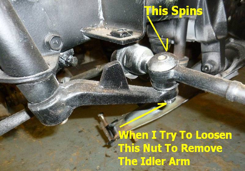

This might seem simple (and probably is) but I can't get the idler arm off the damn thing! The castle nut spins the entire through bolt assembly when I try to remove it, I used an air wrench to try to blast it off before it could spin, no cigar. Tryed clamping it with a C-clamp, no cigar, I'm out of ideas.
*BTW, I did try to remove the large nut that anchors the arm to the frame, HA! GOOD LUCK! I had a 6 foot breaker bar bending like a bannana and it wouldn't break free!

I would try to hold that rounded thing from spinning with a pipe wrench, you may be able to grab an edge with that.
While someone is pulling hard on that 6 ft breaker bar, try whacking the bolt head hard with a hammer if you can. If the socket is covering the head remove it and whack it anyhow and try again. This works many times. Impack wrench would help here also.

I got it. I removed the other end from the pitman arm and pried down on it to give it some pressure and zipped it off with the impact. So much for designing for servicability, would it have bee so hard to put a hex or at least two flats on the stupid thing? :egeek

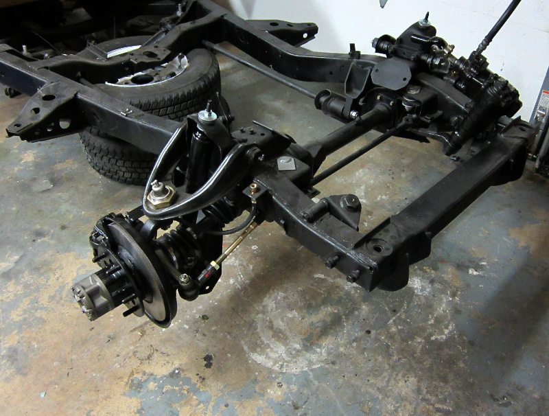

Well it's comming together finally! I am just waiting for a few small parts, brake flex hose clips and some strut bushing kits to arrive and I can button up the front suspension and put the wheels back on. I discovered that one of my hubs has a cracked cover from someone tightening the bolts wrong or something, looks like I'll need to find one somewhere to replace it.
Does anyone have a procedure for reinstalling the hubs properly so that I don't have the same issue?
