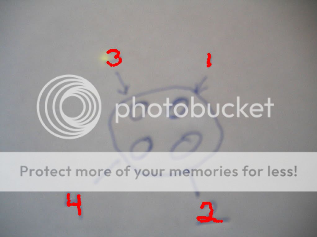

we believe we have the firing order correct
http://i363.photobucket.com/albums/oo71 ... G_0272.jpg

Agree with above. Fireing order is 1-3-4-2, and distributor turns counterclockwise.
