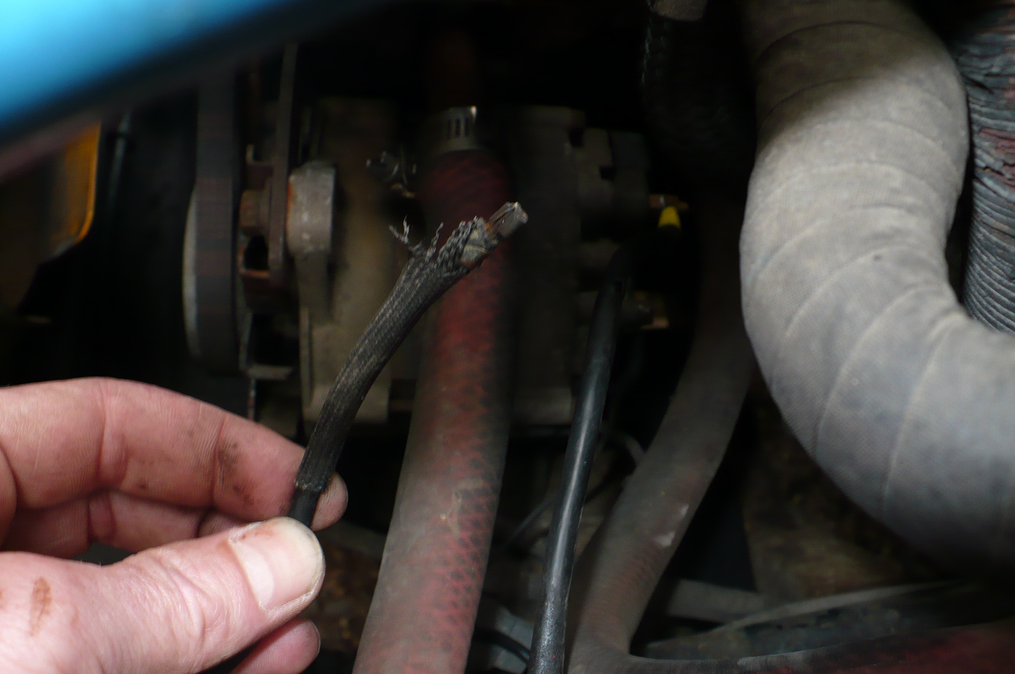

Thanks for the good advice guy's, that is exactly what I found. The main wire to the alternator was in fact completely corroded off. Luckily I have a spare complete wire harness I got through a trade from Costa and it had the exact wire I needed. now I'm recharging the battery and cleaned all remaining contacts so I'll see if that fixed the problem here in awhile....

Found the problem.
