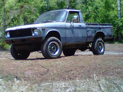

i have an '80 4wd luv that wont idle. whenever its first cranked it runs fine, throttles up and down smoothly but after a short time it wont idle smoothly unless the choke flap is nearly closed. it you throttle up and quickly in short bursts it stays up but when you let off or try to throttle up smoothly it dies. please post on this ive wasted enough time NOT driving this truck. goin to pick up condenser and points for my distributor today
File comment: two hundred dollars paid for my new trail truck
