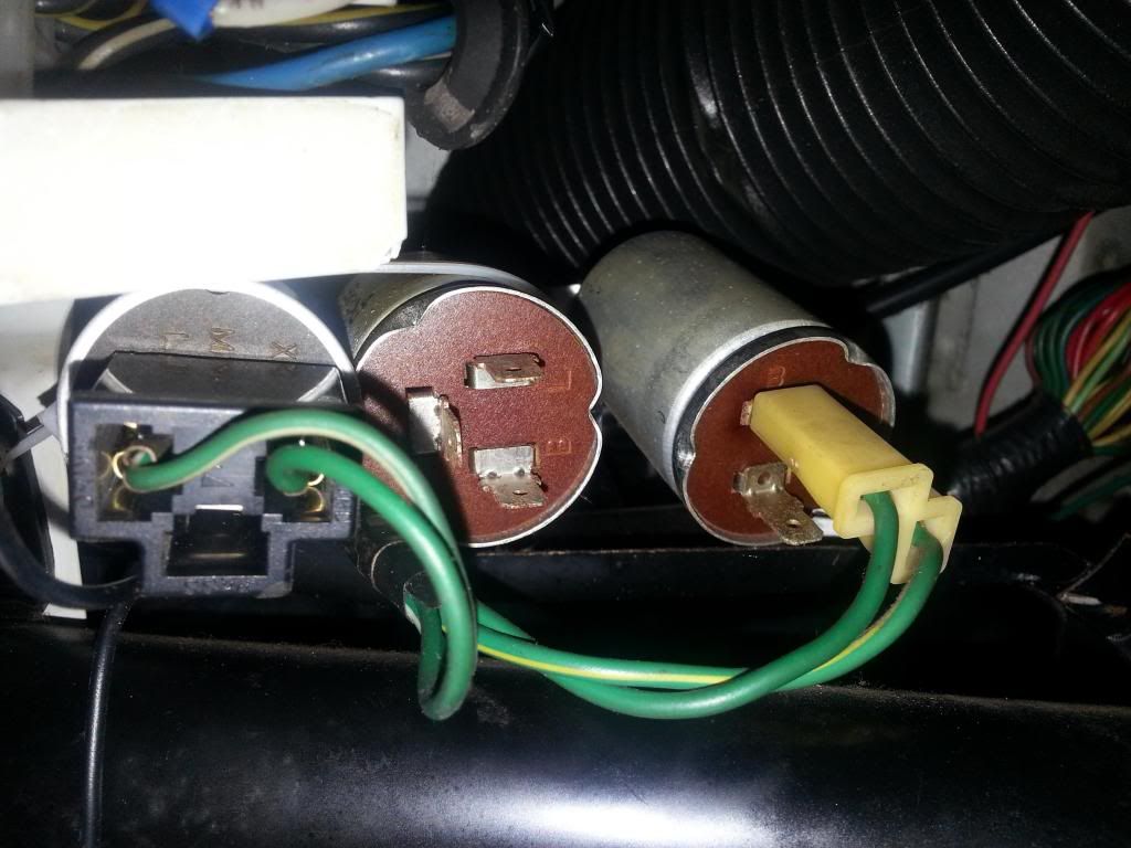

there are also TWO flasher "relays" in our trucks. One for emergency, one for regular turn signals.
take a good look by the toebox(where the pedals are) and look for the two silver(at least they are usually silver) round cylinders and switch them if it works, then replace the bad one.

if you get down by the pedals and look straight up they are 2 silver cylinders one with a black plug and one with a white plug, close to the stering column, they probably fried with the stereo and the other wiring

I fixed the blinkers. My front left is out, but I'm assuming the light just burnt out. The other 3 work perfectly. I had 3 of those cylinders. Uploading a pic now. I just swapped one of them and it ended up being the blinkers.

i swapped the black one to the middle and voila, worked.I can't figure out what the middle one is for, and if there was ever a 3rd cable connected somewhere. Maybe one of them powers my back up lights? Because those haven't worked for years. lol
