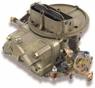

If I remember correctly the linkage of 5200 and the 2300 is opposite of a Weber. I thought in the first post you were talking about the 2300, but then I thought I was mistaken and it was the 5200 being mentioned. Now I know which one you are talking about.
Here some pics
Holley/Weber 5200
Holley 2300

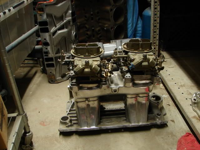

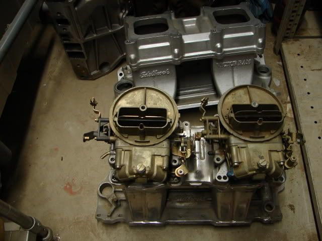

I think if you don't mind do a few mods I would try it. The linkage can be hooked up to the lower part of the linkage so you don't have to run a longer cable to run it off the top of the linkage and loop it around. IMO- The adapter need to be a bit taller than a Weber and be tapered to make up that the Holley throttle blades are bigger than a Weber. Post some pics what ever you do. Good luck.
I thought of doing the same thing, cause I have 2 of those Holleys. I remember that Webers was so easy to install, I went that route instead and was very pleased with the results. I planed on using the pair of 2300 on a tunnel ram, but I'm think of using 2 Webers instead to see what results I might get.
