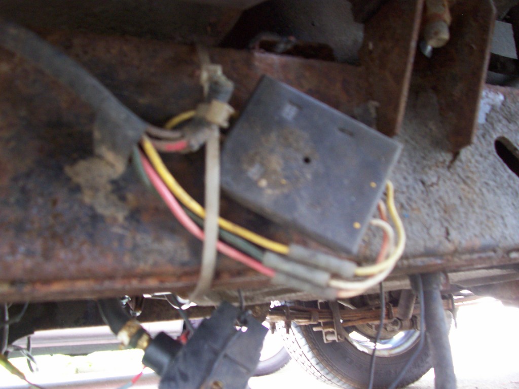

a dead short somehow, which"Could" that prevent a solid good spark? if so, since I'm set up all stock, wouldn't redoing the ignition system(getting a solid, stronger spark) fire her off again? Maybe a msd, with a better coil, or even converting the breaker points to electronic.

As suggested before, it looks like a trailer light converter. Where do the lights run? Is there a trailer plug? If it just connects to lights, it shouldn't affect the spark with the lights off, and I doubt with them on either.
PostPosted: Fri Nov 05, 2010 7:55 am
See this topic, :evil:
http://forums.luvtruck.com/viewtopic.php?f=5&t=23452

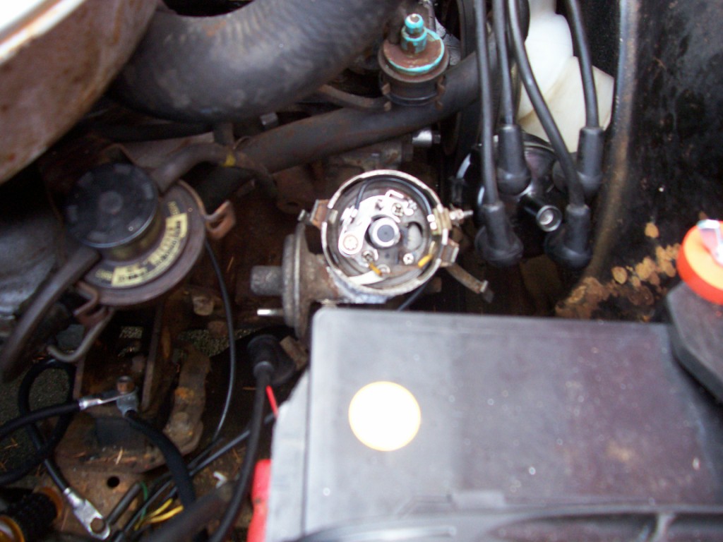

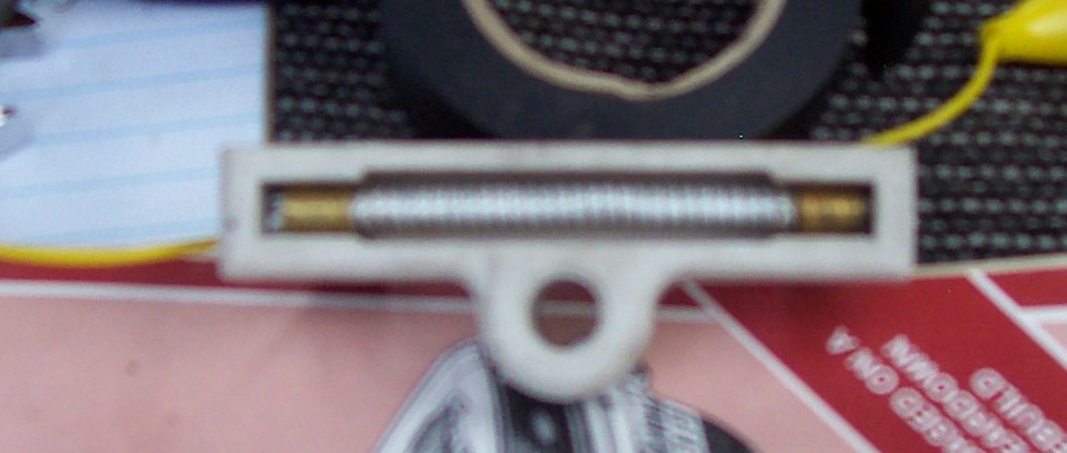

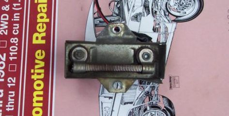

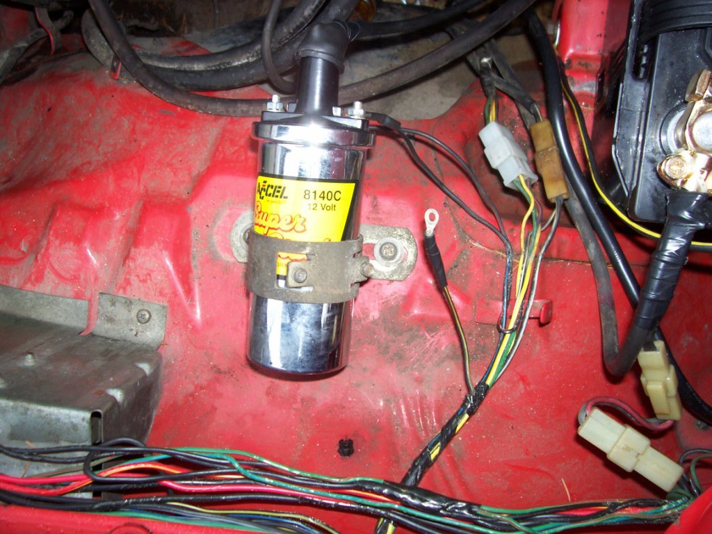

Posts: 130
Here are some photo's. I put a Accel super stock coil in so far as the old ones secondary was out of resistance spec. Haven't tried to push start. I get a brighter spark from #1 plug wire, but not blue. jumper from batt. to coil + didn't fire off when cranking over either. hasn't ran since august. I smell gas when cranking. Stock resistor looks burnt. Have a backup one though.

points set up & back up resistor
