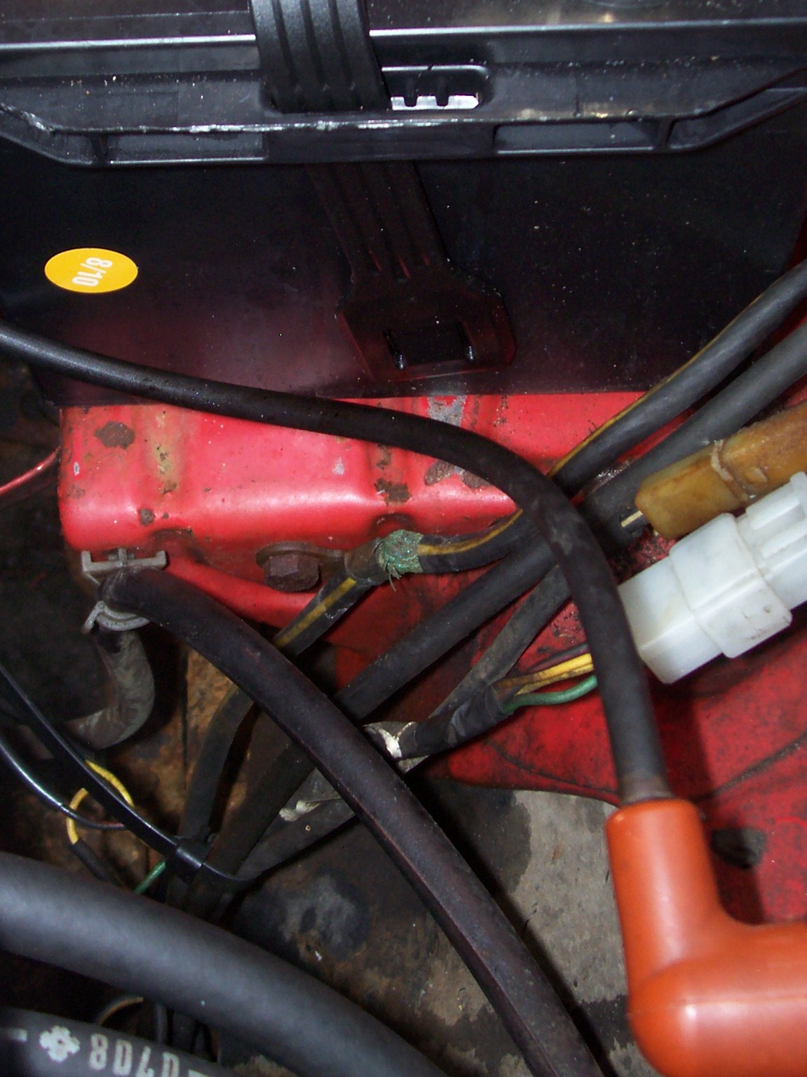

One day after it rained my 1980 luv wouldn't start. So I checked voltage, coil is putting out a yellow spark. New cap,rotors & plugs. REbuilt the stock carb. Cranking it over & no spark at the plugs when grounded to the block. A few weeks ago I noticed a cell went & the battery was leaking acid. Got on alot of crap & was running down the ground cable. So I did the baking soda & water cleaning method & the cable where it clamps to the battery stand is all nasty(see photo) so could this be why there is no spark? Rotor spins fine, new condensor and points.

PostPosted: Tue Sep 21, 2010 10:17 am
Posts: 548
Bad grounds can lead to all sorts of problems. That is why you see frequent suggestions to check your ground when trouble shooting. I can't say why it would turn over and other things work, but the spark would be weak. That is what can happen.

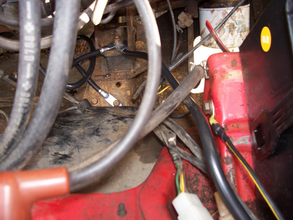

O.k. Did replace the bround cable & straps to chassis & body, from the block. BUt still experiancing 7.5 volts from neg. cable to neg. battery post. Noticed my washers wont run when key is in ACC or on position. it this normal or possibly causing the dead short, resulting in no spark?

PostPosted: Wed Sep 22, 2010 5:00 pm
Posts: 155
Location: Sturgis, SD
With nothing electrical on what voltage do you get if you put the voltmeter on your positive and negative battery posts?
