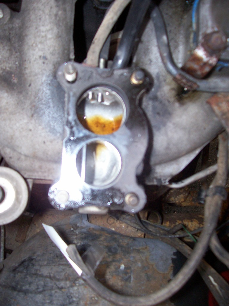

The choke is free moving & the glass sight was showing 1/2 way to the white dot. Then after being cranked for about 10 seconds, it raised tvery close to the dot. I tried spraying it to start and no go. sometimes after a long period of running the starter, it may fire on a few cylinders. BUt wont catch. Plug's aren't fouled either. Not wet, except # 4 cylinder, but it is only 10 pounds off the other 3 in compression. I noticed one vac. hose is cracked where it meets the nipple where it runs from carb. to intake. The carb is leaking some gas from the riser and other gaskets are bad off. So I bought a rebuild kit and when I removed the carb, the fluid sitting in the manifold doesn't look like good gas. So did a glass jar fill from the gas lines that run to the carb and that is way normal & clean looking. I will see if I can attach the photo' It looks off to me. Will look into the fues panel. BUt I know the Volt. regulator is getting power and charging the relay to run the pump.
