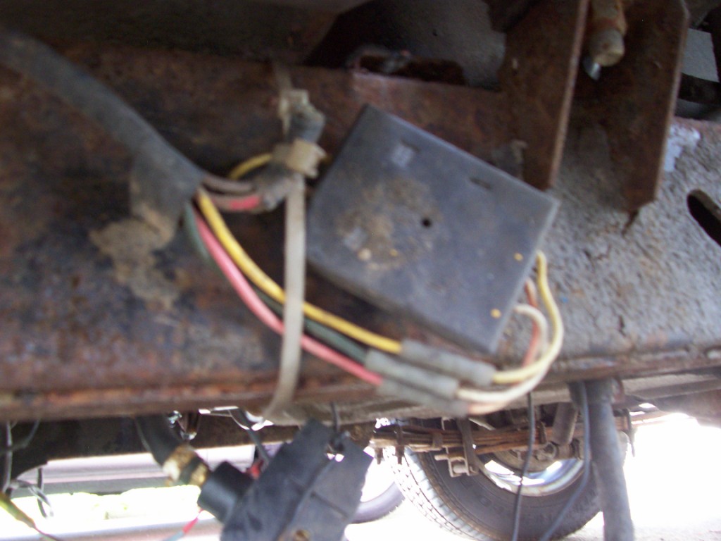

This is a 1980 2wd luv, all stock. SToped running one day after a big rain storm. Redid alot & believe I may have a dead short somewhere which is preventing any spark. What is this box? Could it cause a dead short or no good spark? It is in a spot where alot of rain water run's off it. Also there seems to be a few wires cut at it's location & they are corroding...not covered at all.

looks like a trailer light converter

o.k. cool! Just wondering as I am very curious as to if there is any device that acts like a ecu (engine computer) on this stock Luv.
PostPosted: Wed Sep 22, 2010 8:43 pm
no ecu stuff
