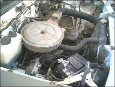

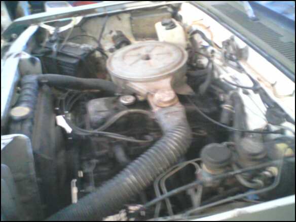

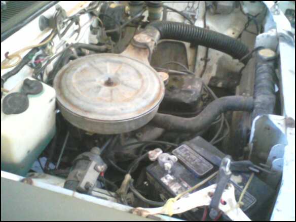

BEFORE:

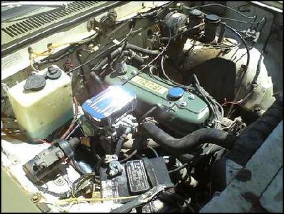

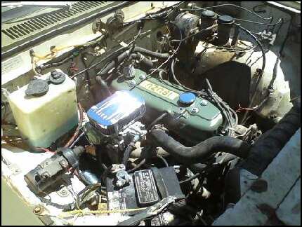

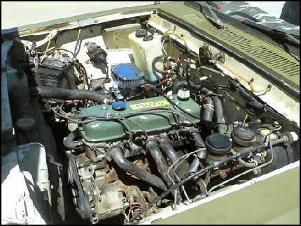

AFTER: 8O
The Redline kit is great, and the Youtube video was especially helpful in knowing what to remove from the stock carb and how to mount it to the Weber.
My black phenolic spacer was intact, so I bolted the adapter(s) to it rather than to try to remove it.
I also got a 3 nipple fuel filter (for an 81 jeep application) designed for the fuel return line.
All told about 2 hours and $350 invested.
Worth every bit of it!
(just need my Offy intake now........) :wink:
Image1980 4x4, 3" body lift, G180/G180 head, Pacesetter header, Offenhauser Dual Port Intake, Weber 32/36, Electronic Ignition, Glasspack & a Smokestack.
