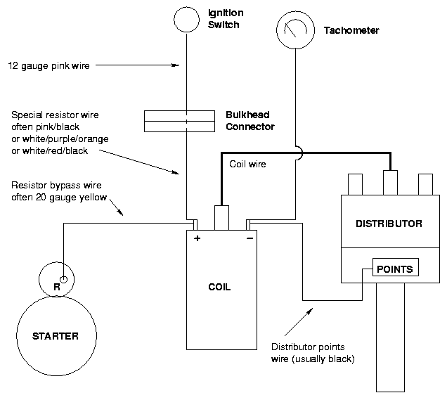

Check your wires, this is a gen wire diagram, but the info is the same. Hope this helps-

That's odd, if you have a ballast resistor for your coil, your coil should not be seeing 12v, but closer to 8 (if I remember correctly).
The coil should not be connected directly to a 12v like in the picture. It should be (switched) 12v source -> ballast resitor -> coil +.
It's a Chevy diagram, early Chevys had resistor wires instead of ballast resistor. Drawing is labeled as so.
