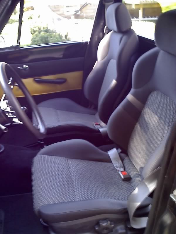

I have 05 Tiburon bucket seats in mine. They fit to the floor pretty good.
 Post subject: Re: New Bucket Seats
PostPosted: Tue Jun 15, 2010 10:15 pm
Those look good in there!
Thanks. I had to make a couple spacers for mine to.
