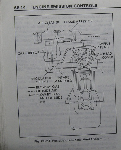

I have not been able to find a post on this subject. The stock manifold has a hookup with a restrictor for the small vacuum line that is connected to the valve cover as part of the positive crankcase ventilation, how is this done with the Offenhauser manifold?
