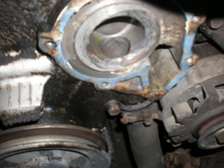

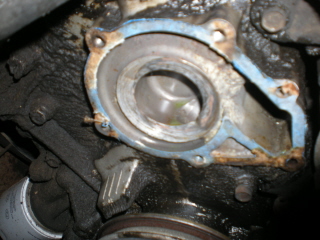

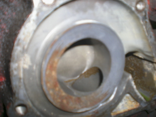

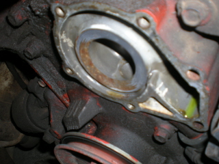

Ok so i took pictures and ill try to explain it the luv im trying to get to stop overheating has had its water pump replaced, i know because of the blue RTV all around it. When I pulled the pump i noticed the housing the impeller uses was chewed up. The pump bushings where fine with no shaft play so here is what i think happened. The original water pump went bad big time bushings shot maybe because somebody tightened the belt too tight. Anyway if you look closely im missing alot of metal on the housing it may not look like much but look at the roundness of the water passageway and youll see theres is a lot of metal missing from that impeller contacting the housing. I took some pics of the good housing on my other luv and the screwed one on the current luv im working on.
File comment: good housing no scaring
File comment: more bad housing look at the roundness of this hole compared to the good one.
File comment: Bad housing look at the scaring from rubbing impeller

had one last pic of the good housing
File comment: look at the roundness of the good ones hole. also no scarring just a little rust stain
