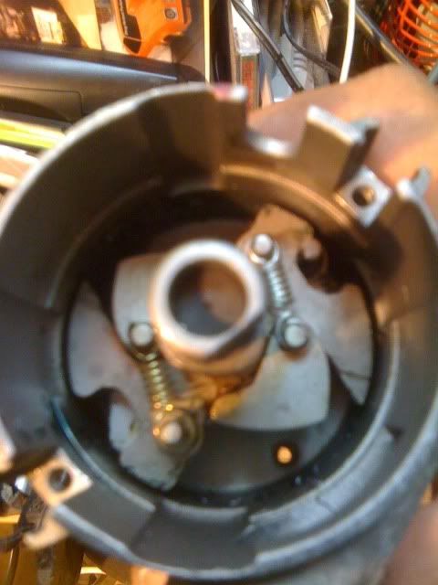

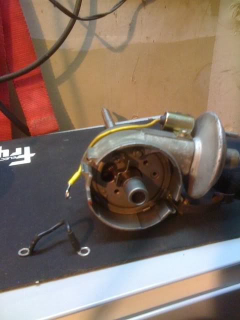

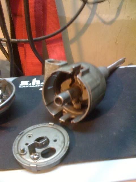

Yup, still working on it. I installed a new coil and even ran a wire right from the battery to the poisitive side of it, but still only tries to start every so often. Have the distributor torn down right now and have a question about the governor weights. Just what do they do? They arent attached to anything that affects anything above the breaker plate. They just move a little plate under the breaker plate and the shaft top isn't affected either. As fas as I see, they could be left out. Any ideas on troubleshooting would help too. Thanks..
Rick

 Post subject: Re: Reassembled engine
PostPosted: Sun Mar 07, 2010 1:34 pm
Posts: 465
Location: So Cal
That's your mech advance. Some race cars don't run them, they run full advance all the time, making them hard to start.
PostPosted: Sun Mar 07, 2010 3:31 pm
Posts: 1251
Location: Loranger, Louisiana
Ok. But how does it affect the timing when all it does is spin? I see no mechanical linkage to the breaker plate at all. While I had the dizzy out, I spun the shaft and watched the plate and saw no movement. I tried twisting the rotor shaft while holding the drive shaft steady and there was no movement there. I guess I am not understanding the interaction in there!

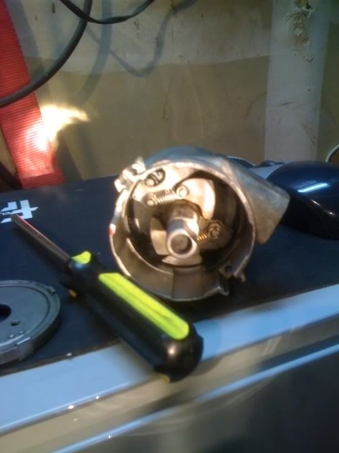

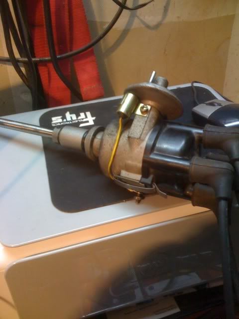

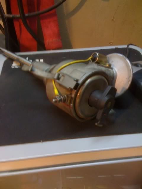

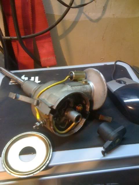

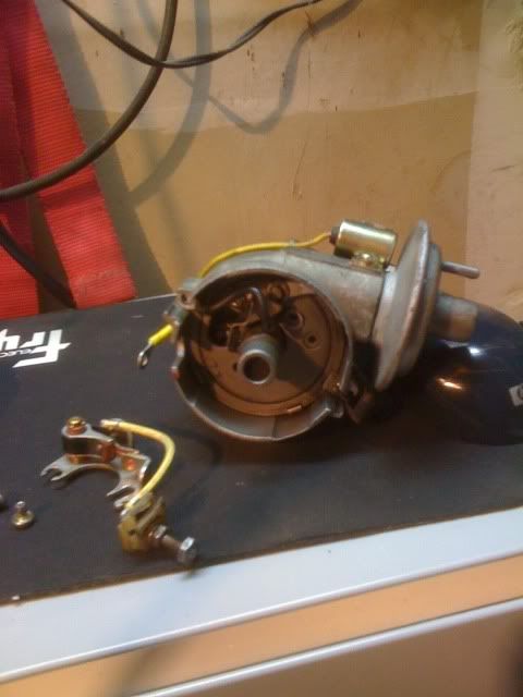

PostPosted: Sun Mar 07, 2010 8:16 pm
Posts: 1251

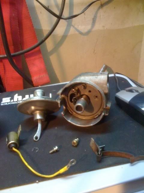

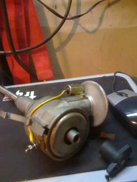

From what I can tell, my dizzy is missing a part or two. Does anyone have pics of their distributor torn down? Last, for tonight, if you try to twist your rotor, does it turn a little or is it solid? Trying to see if the dizzy shaft is a one piece or tow pieces. If it's two pieces, mine may be frozen not allowing the weights to do anything.
PostPosted: Mon Mar 08, 2010 5:58 pm
Posts: 1251
After researching distributors on the internet I have learned a lot. Took mine out again and found the top half of the shaft was frozen in place. A bit of whacking and cleaning freed it up and now I understand how the mechanical advance works. Tried getting the truck to run and still only 'tries' to run, but even with working the gas like a mad man, it stops. I believe I have spent far too much time and money on it, so I drained the gas and have pushed it to the back of the property! :cry:
