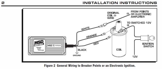

All stays except the ballast risistor is not used-
1st drawings is a 6AL and next one is an MSD 5. Msd 5 is a lot less money and works fine. It has less options than a 6AL
http://www.msdignition.com/instructions ... terms=6420

i bought an msd 6a box today with all of the wiring. i hope this cures my problem. we will find out and i'll let you guys know. i appreciate all of the replies

Sorry for the late reply. The ballast resistor lowers the voltage that is delivered to the distributor points from the coil. At the front end of the resistor you will get approximately 12 volts at the back end of the ballast resistor you will get less. Around 9 or 10 volts I think, maybe less. Mine is a generic I think it is 1.9 ohms. They didnt have the stock one and it was realy expensive 1.6 or 1.8 I think. Too much voltage will burn points fast. I guess it doesnt matter now, but if your points are burnt they are burnt. I dont know but Id bet that the coil you bought has an ignition resistor built in to it. After I found this website I learned a ton by going to the oldest page and reading forward. Good Luck
