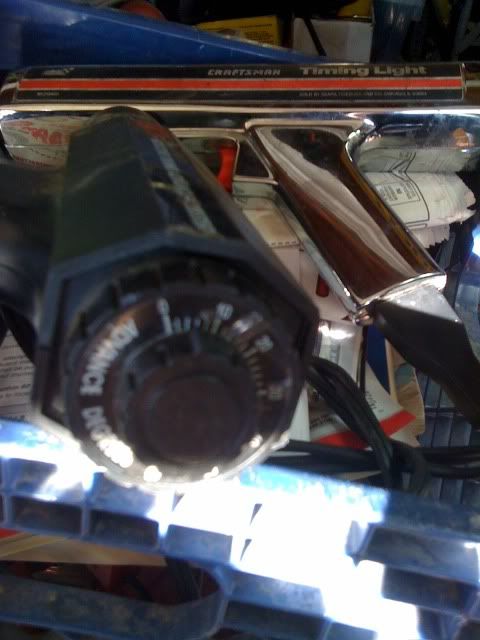

That seems like a neat idea, I'm going to go read more about changing distributor advance curves. I assume putting in lighter springs lets advance come in a little sooner, which for WOT operation could be good.
I have notice LUV motors love advance and respond well to curve kit. I live in 2700ft and can get away with the lightest springs, but when I go into Los Angeles I have notice it will ping just off idle unless I run premium gas. With the light and medium spring I can run low grade gas and not ping at all and get good throttle responce at 2700ft and at sea level. Use a timing light with dial back timing advance and gragh your curve according to rpm vs timing. My curve is in all in by 2800 rpm.

Here is some more dist 411-
