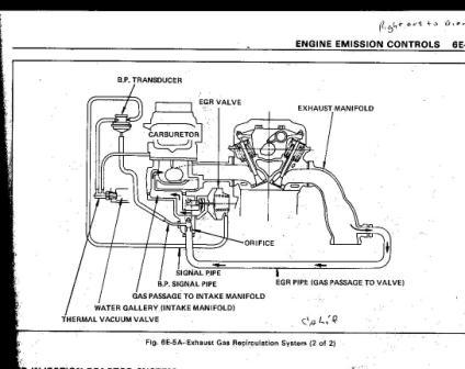

Your vacuum lines maybe crossed I can't tell by your last pic. If you lines are wrong your eng will not idle right.
It would appear that you have a Calif smog truck if so here is a diagram to help. The two vacuum ports below the carb. on the battery side (right side of the eng.) the one on the left side go's to the Transducer, and the one on the right go's to your distributor.
Hope this helped.

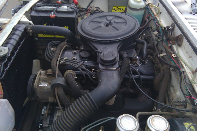

Your spark plug wires look really old in the pics. Check the resistance and get yourself a good set and it could be the problem. Get some new spark plugs, cap, rotor and points while your at it.

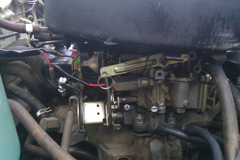

The anti-dieseling solenoid is that hexagone looking thing with the red wire on it in picture #4. Should be 12volts on the wire when the key is on, 0volts with the key off. There is a plunger/needle on it that is pulled in when power is applied, with power removed the needle is pushed out by it's internal spring and blocks a port in the carb shutting off the gas flow to the idle circuit in the carb.
I suspect the carburator may just need adjusting properly.
Make sure there are no vacuum leaks and every vacuum line is in it's proper place. Start by warming up the engine to normal operating temperature, then shut it off. Turn in the carb mixture screw (right one in picture #4) and lightly seat it. Then turn it 3 turns to the left as a starting point. Start the engine and note the speed and set it to 900 rpm with the idle speed screw (the left one in the picture), then go back and slowly turn the mixture in or out a half turn at a time to find the fastest, smoothest idle place by also keeping idle speed at 900 rpm. Go back and forth between these two screws as needed. When this best point is found slowly turn the mixture screw (right one) in about 1/4 turn so the speed drops just slightly to 850 and you are done, and the truck will meet emissions too.

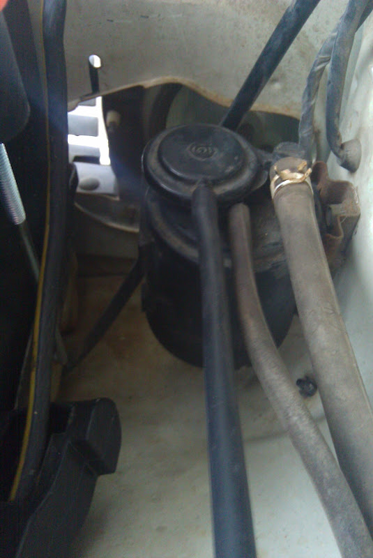

Okay so I checked the vacuum lines, they all seem to be in order. Does anyone know if the transducer is supposed to have a open hole on the bottom? I noticed there is a nipple on the bottom of it that looks like there should be a pretty thick hose hooked up, but I cannot find anything that would go there? It sucks air from that hole pretty good, but seems like that might be what it is supposed to do. Also from what was posted earlier it sounds like the anti-dieseling solenoid would need the spring in order to work correctly, does anyone know where I can order a new one? The ones that I have seen online do not look right...

Yes the transducer hole at the bottom connects to a metal tube with a rubber sleave on the transducer end. The tube should go to the EGR crossover/EGR valve area at the bottom of the intake manifold. Looking down at the transducer kinda underneath it and down and to the left. This tube samples exhaust pressure at this point.
From what I can see in the picture it looks like your smog air pump is kind of non-stock and hosed up. On my 79 the diverter valve was mounted on the pump itself, not over on the right side above the distributor with hoses running across the engine, etc. Of course mine was a 79 and not an 80, maybe that was changed I don't know. Maybe someone on here knows for sure. It almost looks like someone had to scrounge up a system maybe from a Toyota or something and tried to adapt it to the Luv. Anyway the attachment diagram above from woodmanhc shows how the transducer valve is connected. More help I hope.

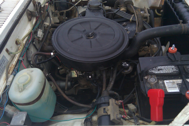

From what I can tell from compairing to the Haynes manual I have all of the smog equipment looks stock.. The smog pump matches the oe on rockauto.com... hmmm... question about the transducer, just so I am not mistaken the transducer mentioned above is a plastic canister near the battery?

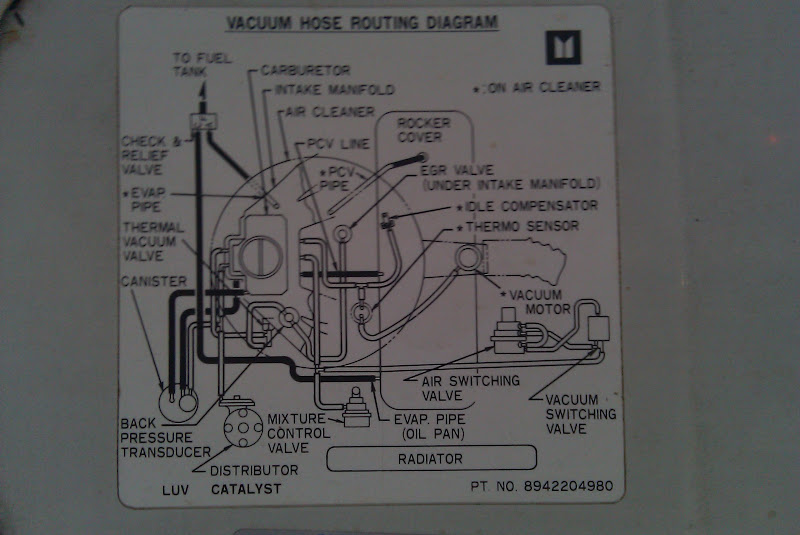

My truck has a vacuum routing diagram under the hood that looks pretty different from the one posted on here. Must be a difference with a 1980 California 4x4.

The transducer is in picture #5 off the corner of the battery in the photo but mounted on the intake manifold. Looks to have some white letters scrawled on the top. The plastic canister in your latest photo is the fuel tank vapor canistor.
