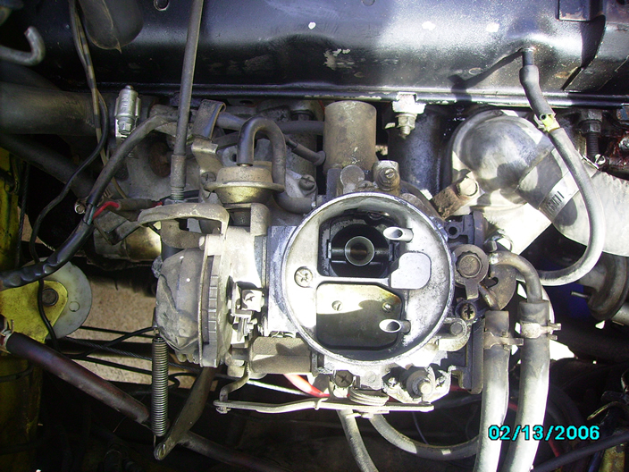

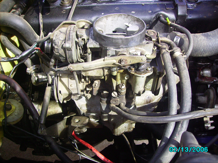

On my way out now to check the throttle plate for slop and snap a couple pics.
(Pics to follow in a few minutes)
File comment: Top down view of my carb.
File comment: Passenger side view of my carb.
What happened? Where do I go from here? What carb is this?
Thank you in advance for your time.
Clint

That's the stock hitachi carburetor.
If it's revving high, but running smooth, the problem can only be a throttle plate open too much. Any leaks, like vacuum leaks, would make it run rough.
When it's at idle, the secondary throttle plate should be fully closed. If it's open at all, then something's wrong with it, or with the mechanism that opens it.
At idle, the primary throttle plate should be almost closed.
I notice from your picture the choke is almost closed. I assume it's because the truck is cold. However, when the choke is closed, it bumps the idle up. If the choke isn't fully opening, the truck will idle too fast.
Look carefully at the throttle mechanism on the carburetor. I suspect something's keeping it open too much. Things I've seen that could cause this:
- a weak return spring not pull the throttle all the way back
- the choke mechanism not allowing the throttle to fully close
- the throttle cable catching on the carburetor and not allowing the throttle to fully close.
Hope this helps.

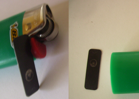

Ok, got some extra time before work this A.M. Took the carb off and turned it over.
The secondary plate was indeed held open.
by this:
It was lying on the top side of the secondary, sticking out just a little and holding it open.
It was held there by just a bit of oil creating suction kinda.
Where did this piece come from? It is made of steel. What is it?
I looked through a rebuild kit a my friends shop, didn't see it.
He happened to be rebuilding the SAME carb but off a 1970 Datsun... imagine the odds.
He told me he didn't recognize the piece from anywhere.
Thanks again all for your input.

Except for it being metal it looks like the lid to a hitter box. I say you got lucky it got stuck where it did.
