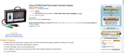

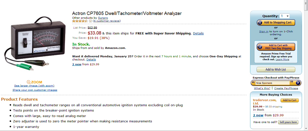

I have a Tach/Dwell/Volt meter that I use for engine tuning. If you have points then you really do need a dwell meter. I have this one
http://www.amazon.com/Actron-CP7605-Tac ... 106&sr=8-1
