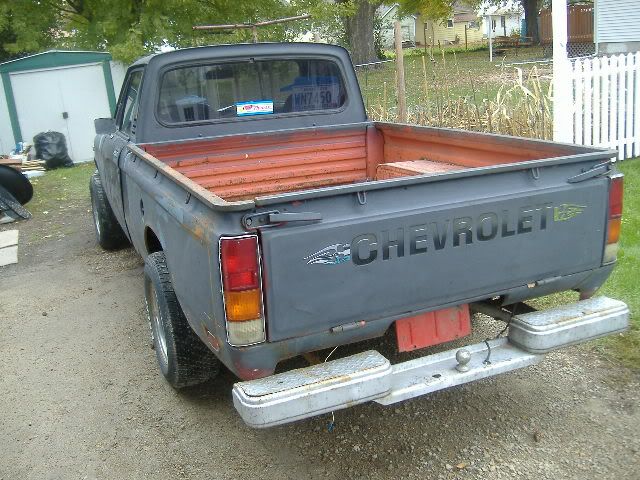

got a 77 with after market wheels on it but there a little wide, what are the factory wheel speccs? (size, dim, offset, ect) Also looks like the drivers rear wheel id out more then the pass. side, were the rear ends offset that way?

I have had several Luvs with stock wheels, they were 14" x 5".

I think mine are 14 x 4 and offset is same for front and back wheels, 3.75" I believe. I have another post on here somewhere with it, use search.
