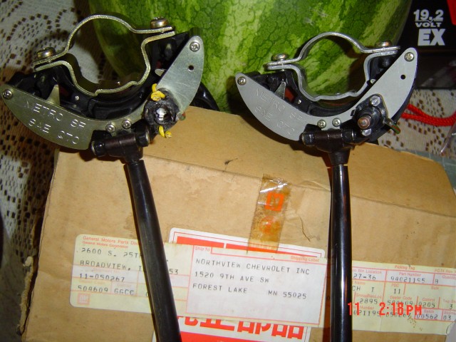

I replaced the spring on the horn button (switch on left) after I installed the switch it started to smoke and the plastic button holder melted. I got a new one and after a month it failed. The same thing happened, the spring collapsed. I replaced the spring on the new one and the spring collapsed again when I tried the horn. The plastic holder got hot, but did not melt. Has anyone had this happen to them.

You have a short somewhere if it's melting buttons like that. I'm amazed that a fuse to protect this hasn't blown. This hasn't happened to me with my LUV yet. I would start tracing wires starting at the steering wheel, to the fuse box, to the horn. I hate electrical issues, my weakest point admittedly. I can look up a procedure for you and copy it tomorrow if I'm not working. It's a good way to chase a short.

To burn like that you have to be shorting 12 volts directly to ground. Either it is misswired at the horn or the horn itself is shorted out internally. If a Mikado it has a horn relay and two horns, if not it has one horn, no relay.

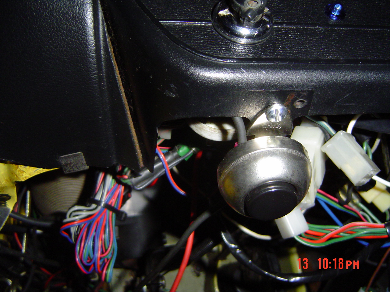

Not a Mikado. I installed an after market horn button under the dash so I can have a horn. That horn button/switch seems to work without any problems. I tied it into the plug from the old switch at the steering column.

This is the horn button I installed. The horn works every time and the button doesn't get hot.
