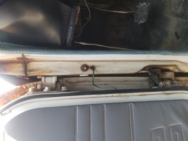

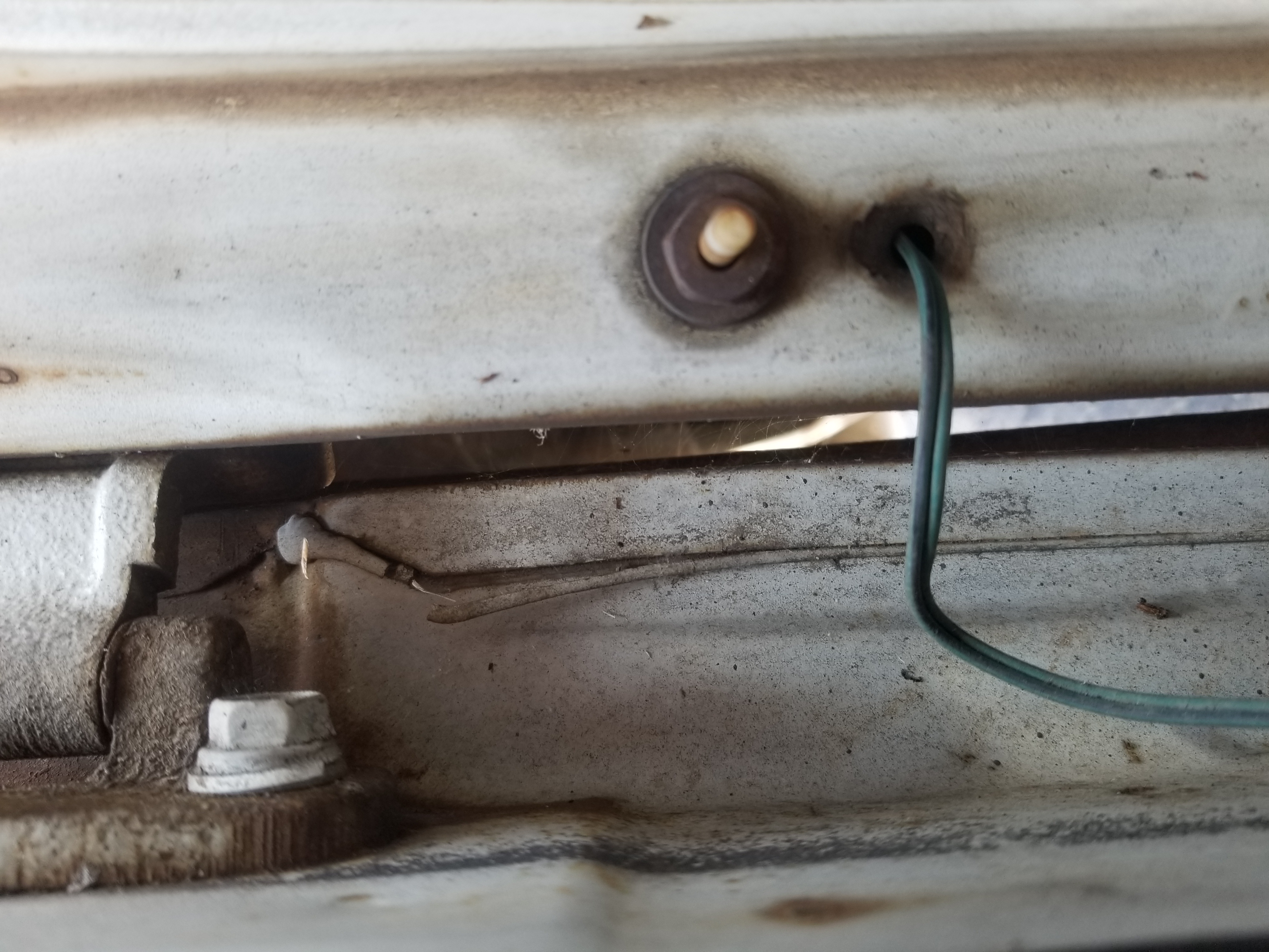

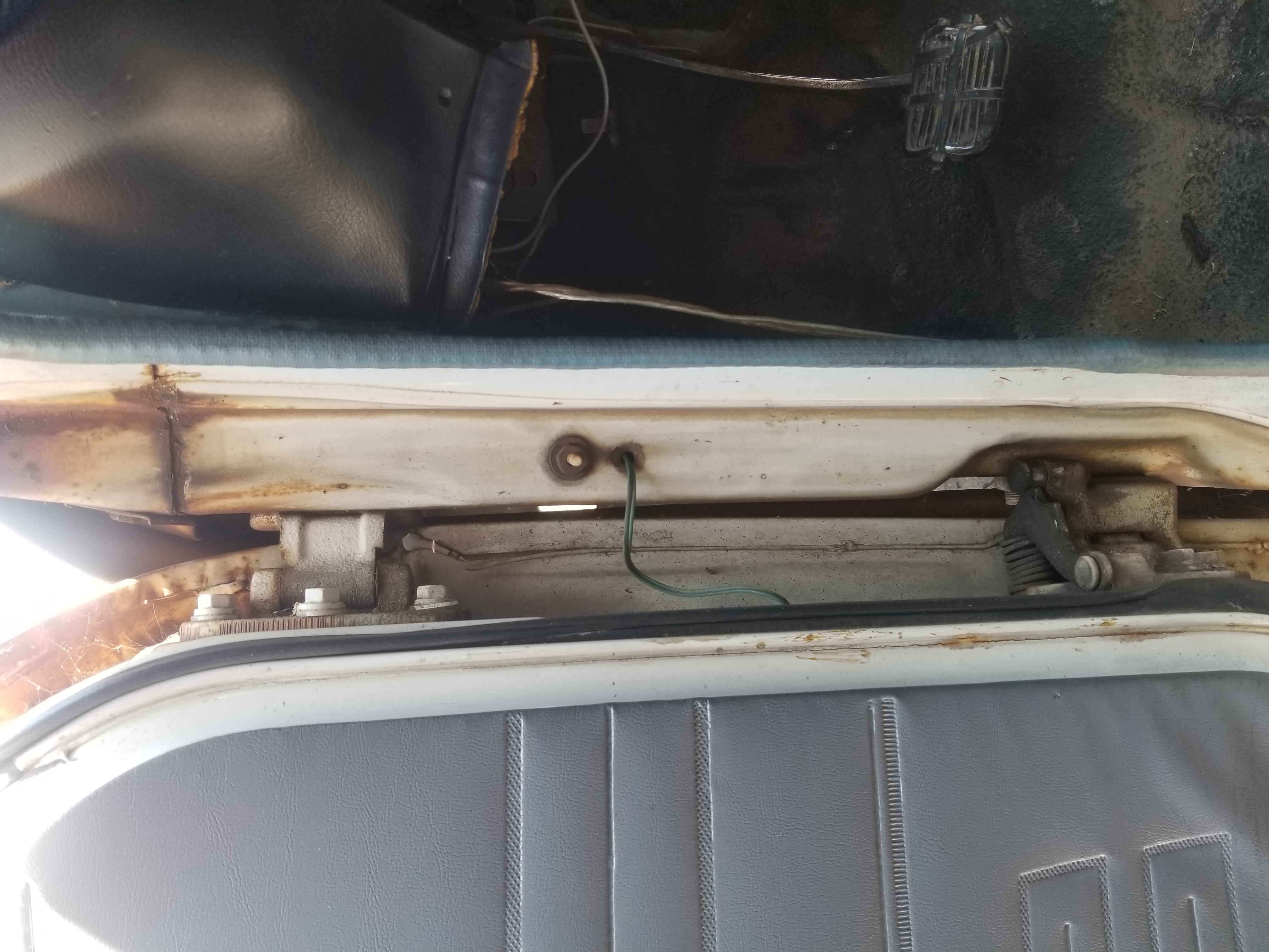

I am going to install new door switches for the dome light and alarm system. Those that have these switches can you please give measurements so I can install in the correct location. I searched and didn’t find anything.
76 LUV
PostPosted: Tue Sep 01, 2020 12:39 pm
I didn't have a tape with me, but it's about an inch and a half below the bottom of the dip in the jamb on the left side. Hope this helps.
