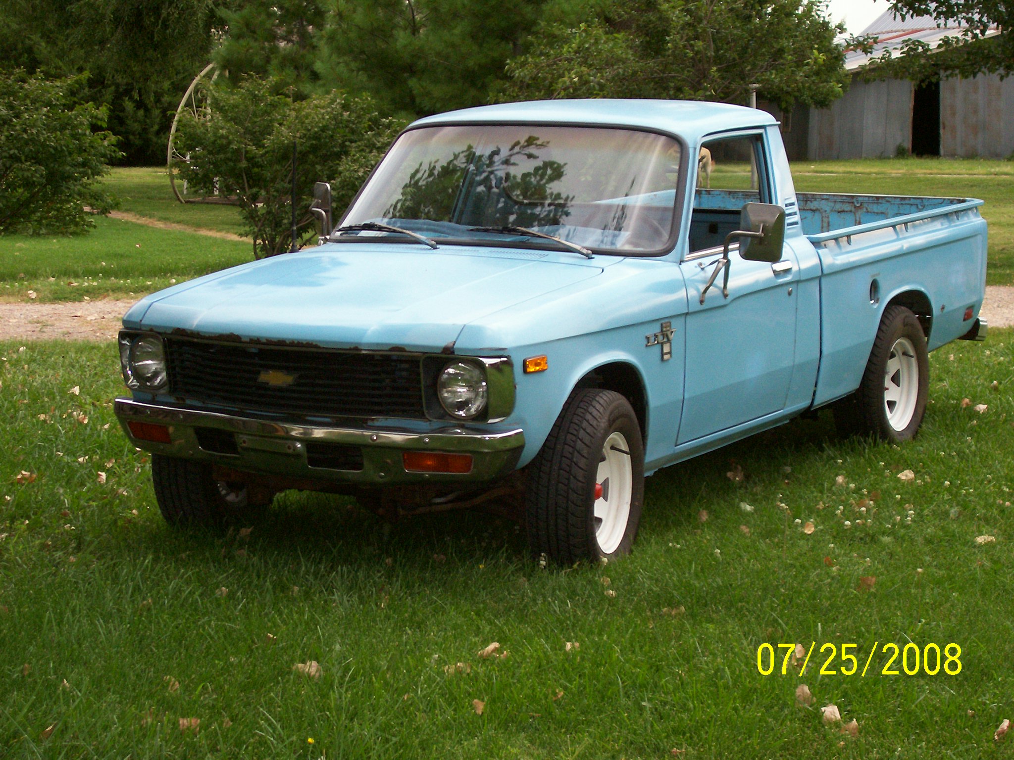

I've got an 80 model 2WD and recently it wouldn't start with the key. Nothing, no clicking,NADA. I can jump the solenoid with a screwdriver and it'll start just fine. So I head down the local arts store and buy a new starter and get it installed, and still have the same problems. I'm thinking it could be the neutral safety swithch or the ignition switch itself. New ignition switch is about $50, so before I spend any more bux is there a way to test the safety switch or bypass it altogether? Any help would be appreciated. I'm at the point where for $1500 I'd be selling this beast to someone. I've done a ton of work on it in the past year, new engine, tranny rebuilt, brakes, exhaust, tires wheels, etc...I'm just plain ol' tired of working on it.
