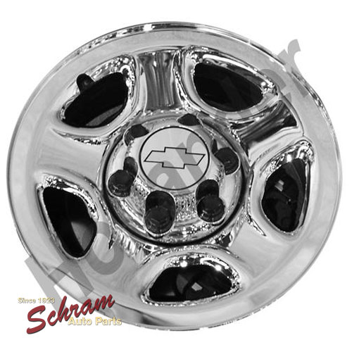

i found that the rims off any 1999-2009 chevy 1500 or chevy suv with 6 lugs will bolt on to a luv

all 6 lug truck wheels will fit the chevy luv lug

There are a few with a smaller center hole that won't fit over the 4x4 hubs and of course some wide rims will hit the upper control arms, but just about any 6 lug wheel will line up the bolt holes with the studs.

I am running 2000 silverado rims on mine. They are 16" with 205/16/55 with out any clearance. They are actually inside the fender well about a quarter inch.

any rim that is a 6 lug with a 5.5" spacing (listed as 6 X 5.5 rim) will work , Nissian Titan/Armada rims look nice too and they are 18" rims. Someone on here had a set on there truck. Also alot of escalade rims will fit also. To get some ideas at what rims will work go to ebay and do a search for 6 lug rims.

Dodge durango and dodge dakota have a lug pattern that is different from any other 6 lug wheel. Thay will not fit a luv.
