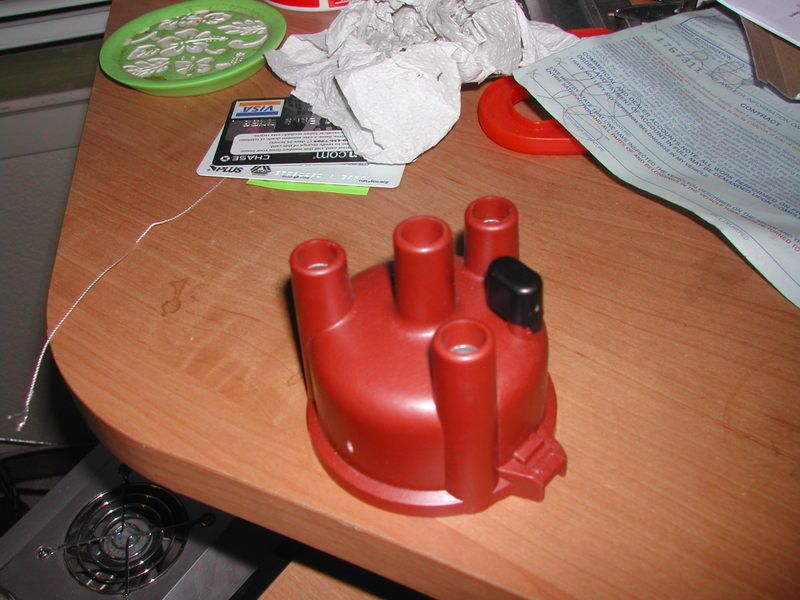

Funny story, Guy at Autozone was so disgusting to look at(not in a gay way but more like a how is he alive way) like he was a mouth breather with the enthusiasm of a three toed sloth, so i bought the dizzy cap and picked it up, but left without checking in an effort not to go wild on this slob behind the counter and mess up my karma(last thing i need right now) and when i got home i looked at. It looked like this
Soo seeing as i don't have an extra geo anywhere... i went to go get a new one. Why must we continue this love hate relationship Oh LUV of mine... :(

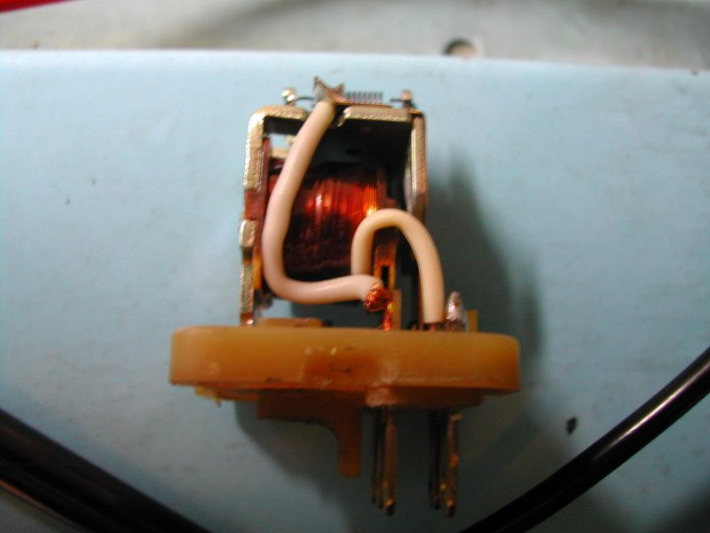

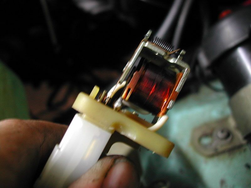

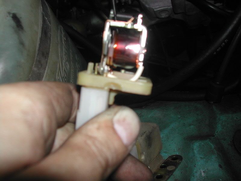

Dismantled Fuel Pump, Took little Clip off of solenoid pump looking thingy gave it twelve volts shot everything against head and garage wall, have a talk with the holy virgin Mary under my breath while i looked for everything, brushed the filter inside the pump with an All purpose brush put it back together Changed the hoses, cleaned the fuses!!! and crank crank crank... nothing..
Checked continuity b/w Fuse box and relay and had power sooo relay must be crap right..
so took it apart
Looks good things click with the ignition and head scratching commences....

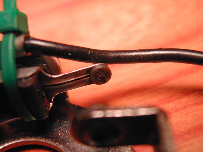

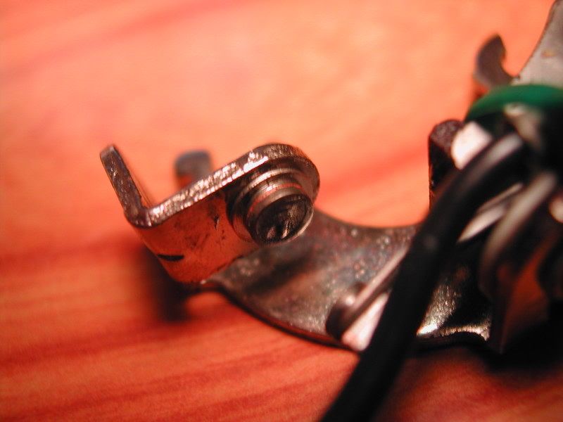

well, i thoughts my points were fine but after i got sooo pissed off that i said, u know what luv i'm gonna cut your points off and viola, this is what i found..
I don't think that these are in their best shape....
any reason to learn the ancient art of Points.
Aren't i supposed to have dual points and a coasting solenoid on my carb, am i an early 1979 LUV??

Yeah points are a pain, and inefficient too. You'll be happy you went electronic.

Dual points were on the 72-74 trucks. Yours look pretty bad, and pretty much impossible to gap correctly with a feeler gauge. Every 5000 miles or so my 76 used to eat them up just about like that, a buildup on one side and a divot on the other. More than once I spent a good half hour beside the road gapping and regapping by eye until I got them close enough to get me home or to the parts store.

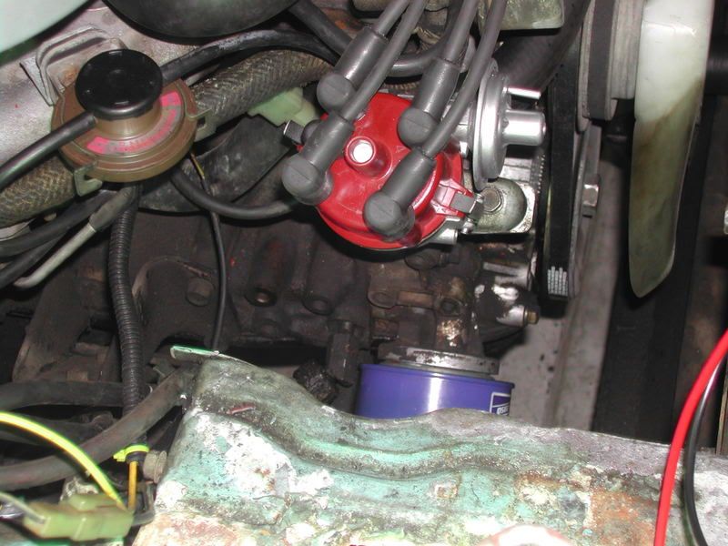

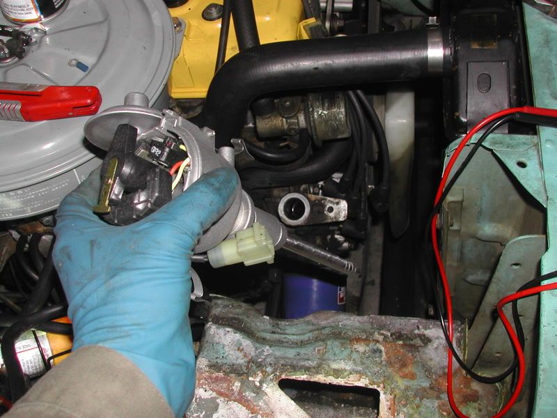

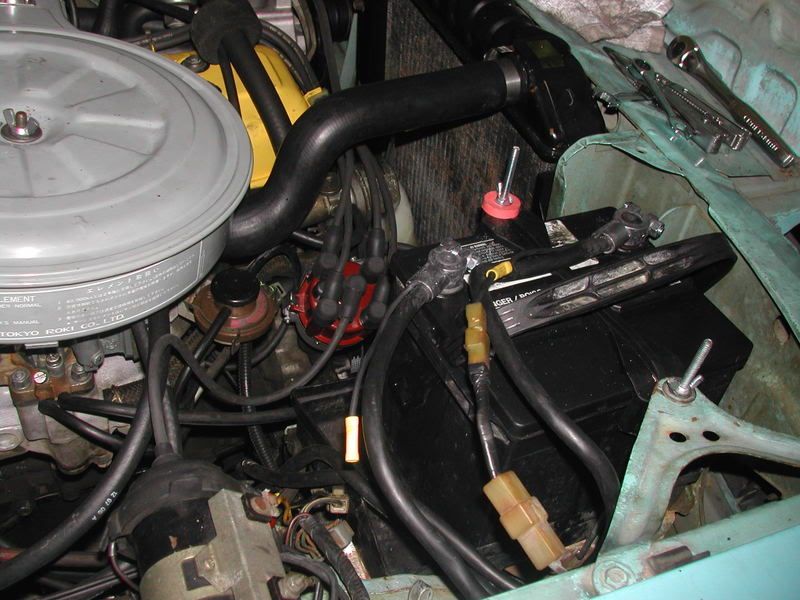

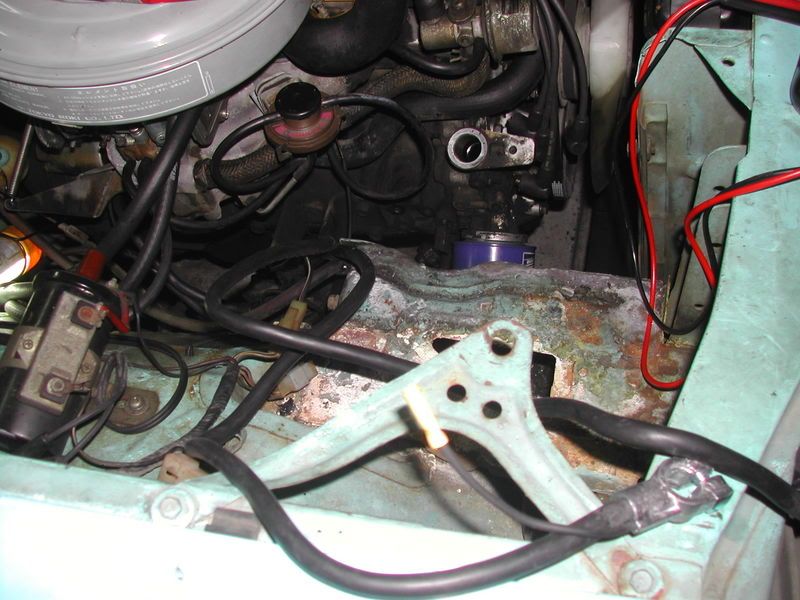

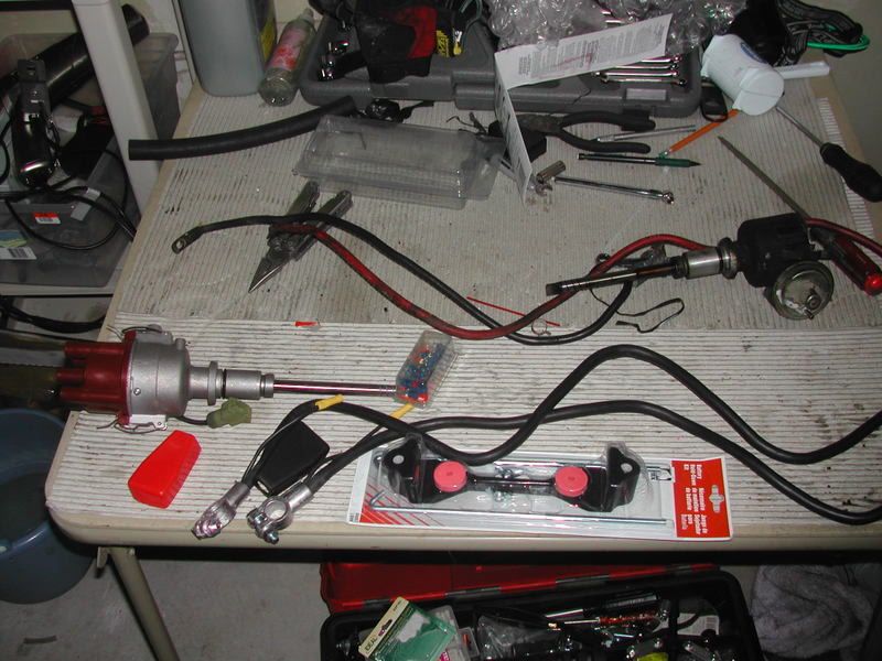

It went in... but i don'tknow if i did it right, maybe there is no such thing as foolproof :cry:
old stuff
same hole
new stuff

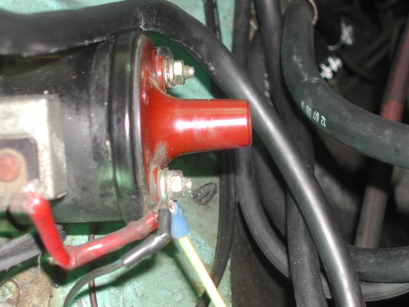

its in
Connected the positive wire for the dizzy to the + side of the coil right??
Is this what i did wrong
This the new stuff in, new batt cables, hold down hardware and dizzy
Started it up but idle rpms were way off as was the timing, adjusted both, idles fine now, idles beatifully.
