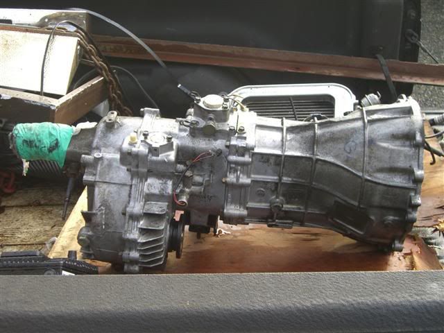

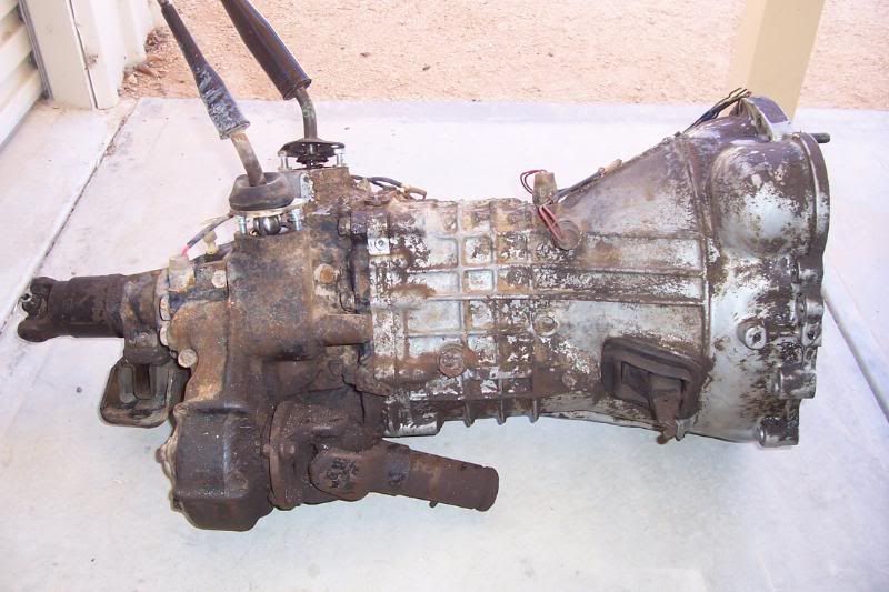

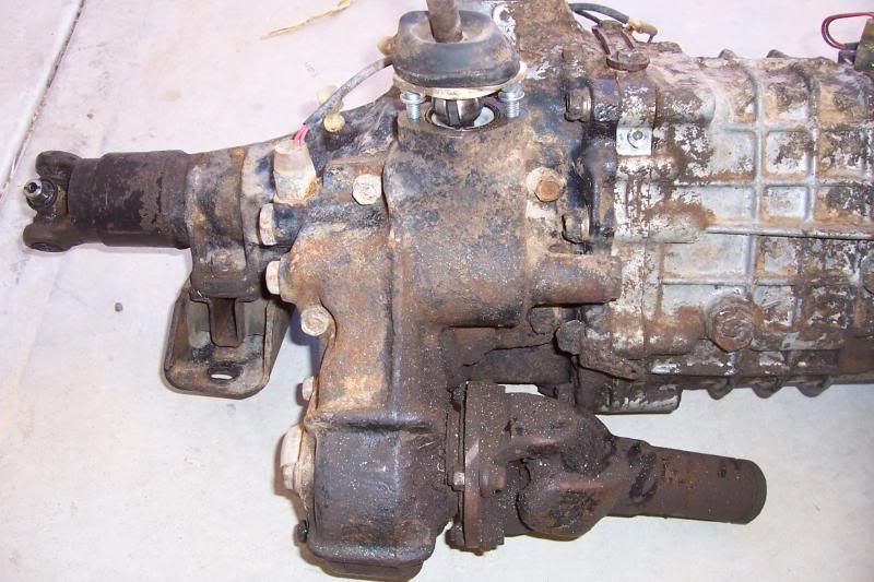

Heres a few pics to ponder over till Bob can help.
GASSER 4x4 4speed
GASSER4x4 4speed closeup
DIESEL 4x4 5speed
1980 4x4 KBD40 ISUZU/Chev Luv

Hey Thanks! Those pics are awesome! It's great to finally see what it looks like. I guess as far double transfer cases go we're kinda screwed huh? The qwest goes on.
