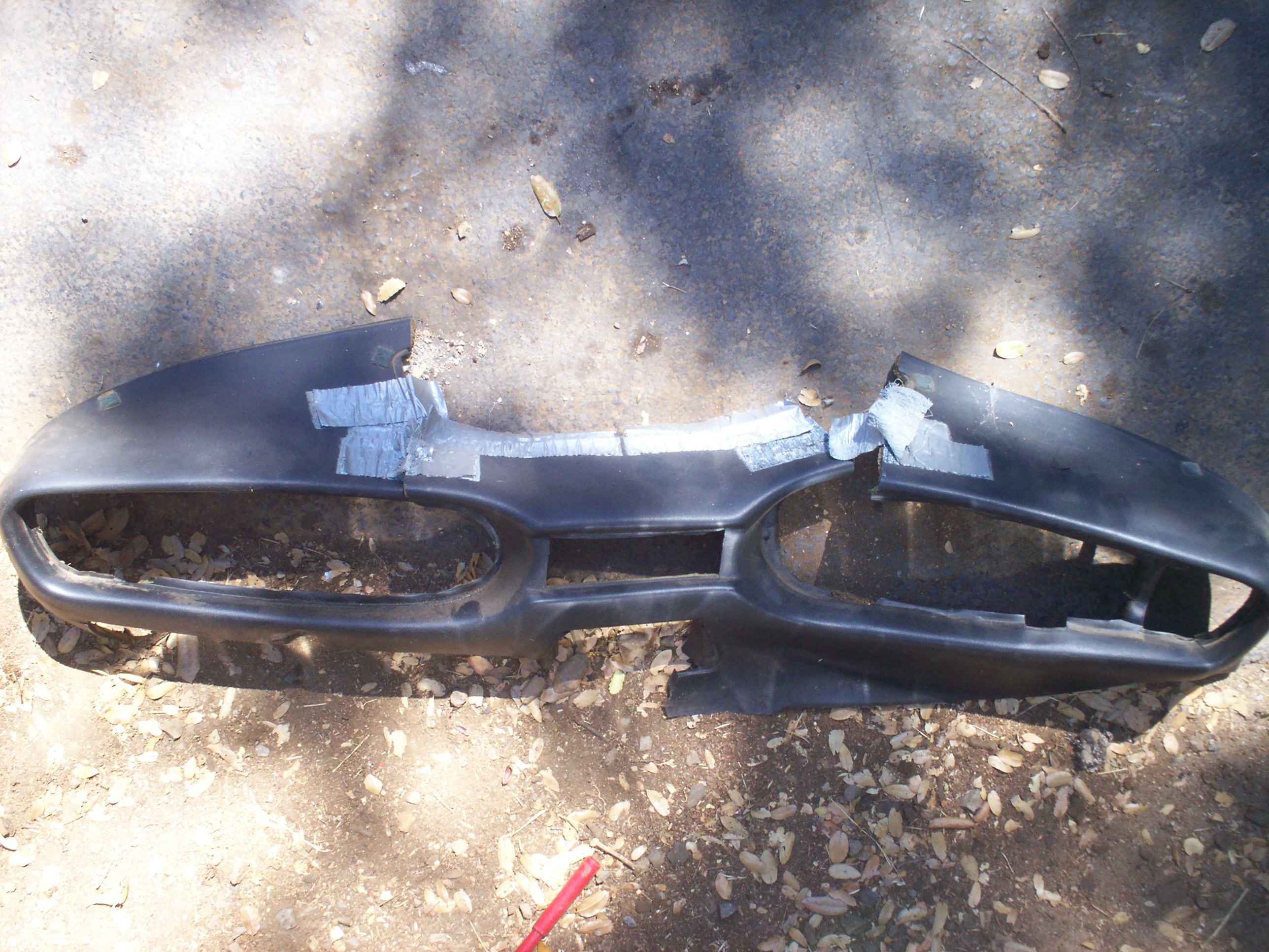

before i relized it was so hard to get a dash about about 4 months ago i decided to take the old one off cause it needs to be replaced the guy before me tryed to fix it with duct tape. when i took it off it fell apart even more its not fixable and i know its just about imposable to find a nice new shiny dash . so does any one have any sugjestions . can a nice one be made out of wood ? is it to expencive to have a custom made fiberglass one made? any sugjestions would be great thanks.

Some people just sand and paint the steel and leave it at that. It has a sharp edges robot / spaceship look to it. :D

Sometimes they can be saved if you don't mind adding a cap, take a look...

ive already ripped the foam off it was too far gone and i just have the metal showing, cap wont help me plus im not going back stock in any way on this truck

this is how i did mine long time ago , cost $15 to do -speckle paint - some boat carpet - door trim and wala

There's white or blue foam sheet used in the building trade, 3/8" to 2" thick, used for insulation panels under roofing or siding. It bends a little, not much. Can be glued in place and if you use the thicker sheet, like 1/2" there's enough to sand it down to contours. Once sanded you can overlay with 1 layer fiberglas roving and spread on some polyesther gel coat. Gel coat can be painted of carpeted. It would still offer some crash protection I suppose and should look pretty good.

What about taking your dash to an upholstery shop? Maybe they could make up some bracing, and make a covering for it.

well i think im going to paint it and put a carpet piece on the top. thanks all for your sugestions once again you all have helped me.
