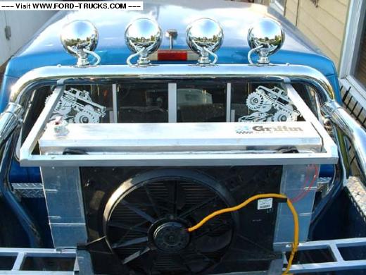

ok this is what i've got now.. the service technician at m/b would not suggest using m/b antifreeze in anything but a mercedes benz.. only difference in m/b and any other is that it is universal according to him.. 49.50 for rodding,,radiator shop says there'z no such thing as too much coolant only not enough.. doing a compression test later this evening.. and advancing timing.. if all doesn't work installing a radiator out of a 75 peterbuilt putting it right in the bed just kidding. thanks for the responses will let you know what i come up with.. and btw i was driving between 70 and 80 defore it overheated and was lucky to get 65 afterwards... down hill.. wind at my back... someone pushing.. and flinstoning all at the same time and we were synchronized

Not to be a jerk, but some of the info you're getting locally sounds like it might be incomplete/innaccurate. A lot of times people are a bit lazy, I'm not sure why a MB guy wouldn't want to sell his coolant. It really does do wonders in older vehicles. It takes a while, but too much coolant usually causes accelerated water pump wear. I'm not ASE certified or anything, and I am not the world's greatest mechanic, but this is an area I've had a lot of problems in also (did I mention I've owned a lot of Saab's?). :eugeek
Sounds like a recore or new rad will take care of this, possibly just adjusting the timing will settle things down.
Good luck, keep us posted on what solves your problem. :)
