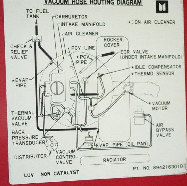

this might help someone who needs it.

Wow, yes!! Good photos Wayne!! I liked the last one, where it identifies the parts for the hose routing. Although my LUV is a '78, the diagram has a part that I recently was concerned about; the check & relief valve. Looks like there are some gizmos on your '80 that I didn't have. I don't have most of it now anyway because I took it all off. I saw your other photos too, good going and keep it up. You'll end up with a bunch of "before" and "after" photos that you'll love looking at and never be sorry for. Digital cameras with a substantial memory card make for taking dozens of photos and there's a good bet that some of those photos will be very pleasing to see.
Thanks for the diagram again. My truck has a different one without the parts labeled.
I don't have the air pump or air injectors anymore, so a lot of my hose routing isn't this way anymore.

Wayne that Vacuum hose diagram on the hood is very helfpul. When I first got my Luv it was messing most of the hoses. I used that diagram to run my new hoses.
