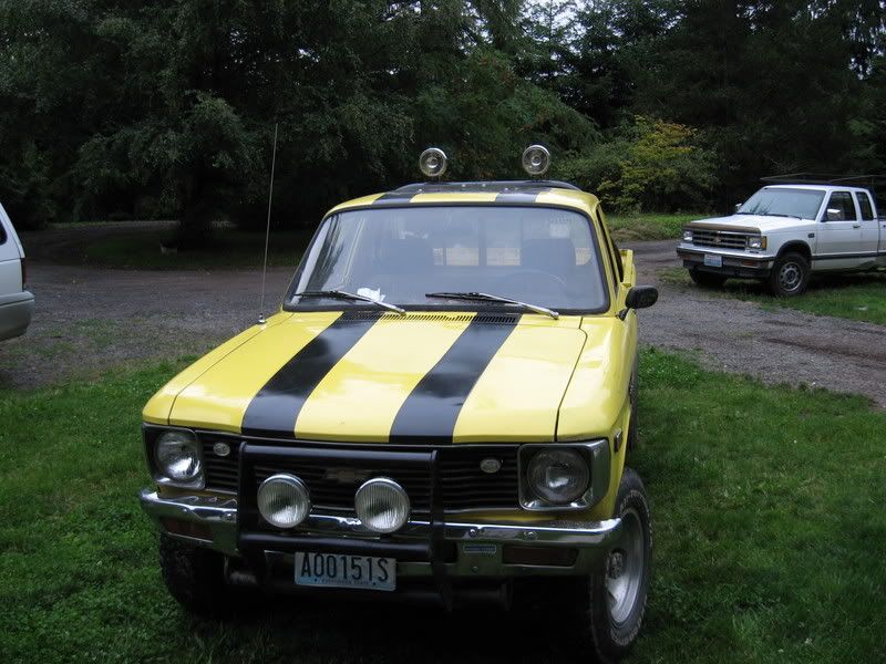

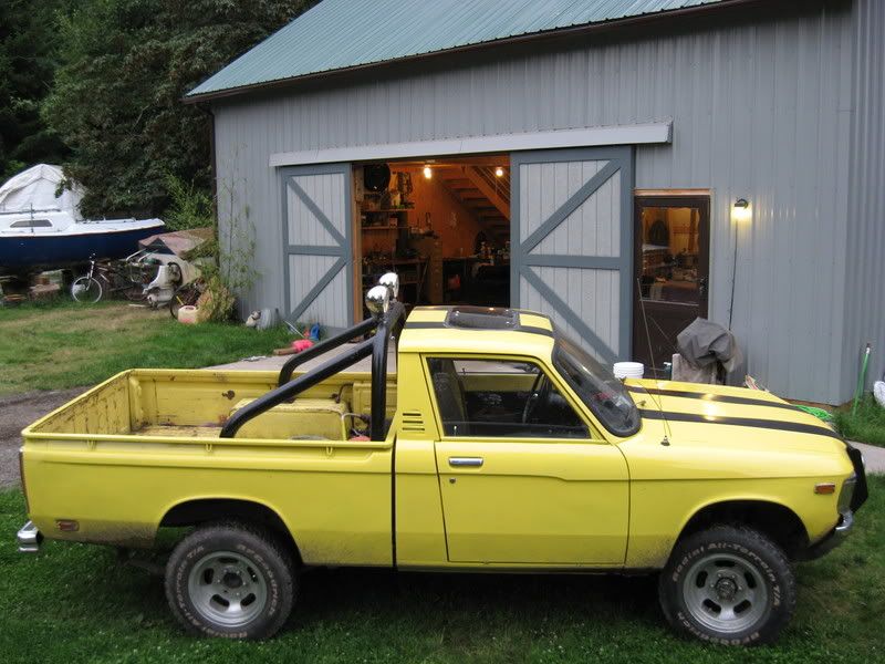

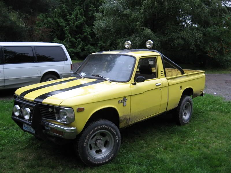

so heres what i've done to it overall... about 2" of lift (shackles in back and torisons up front), removed bumpstops up front to let it sit a bit higher, although now i have camber issues. racing stripes, ansen sprints with 28" bfg all-terrains, rollbar from a mighty max (widened 4" to fit) bullbar (originally from a s10 blazer), some lights, and a jvc headunit with a blaupunkt 150 amp, boston tbx-9's and alpine 5x8's. the cb is all ready to go in.

and picture time...
