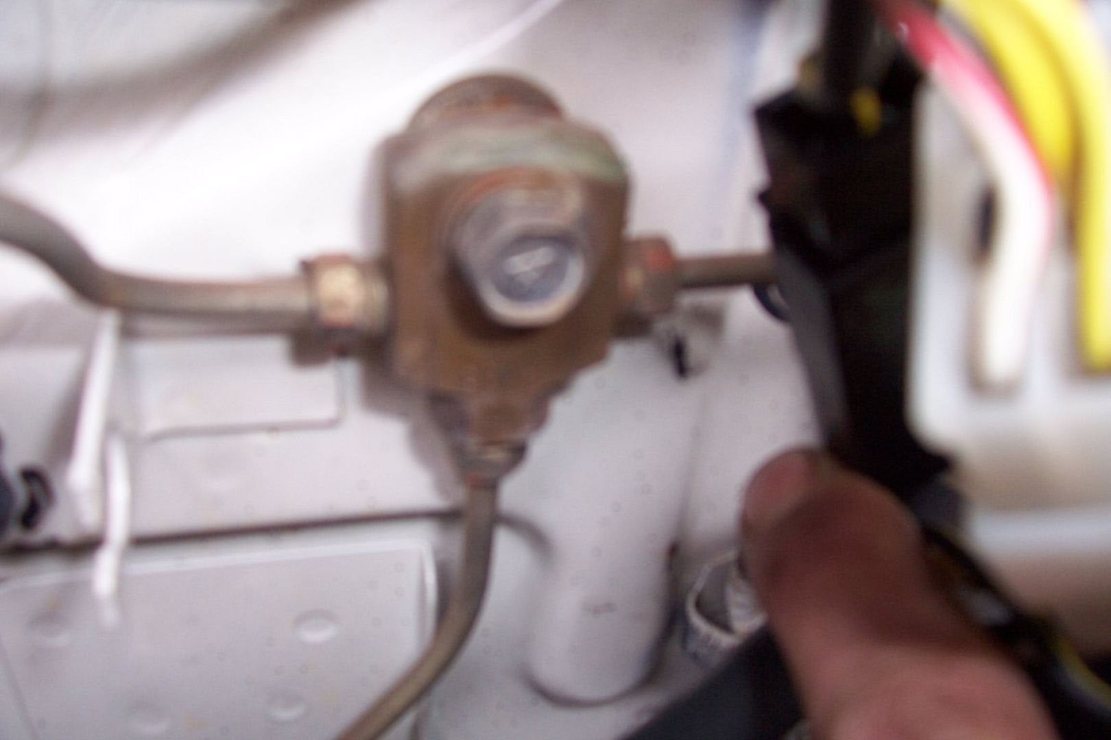

Im unsure where my brake bias valve is.
Image Image Is it built into the master cylinder?

PostPosted: Wed May 30, 2007 10:48 pm
I wouldn't think so. Follow your brake lines down. There should be a junction block. That should be it. I think mine has Nibco cast on it, but don't quote me on it.

Single line travels to rear then splits at diff, single line for front travels to firewall then splits (see pic) two lines travel to brake calipers. No bias valves any where. Image :?

PostPosted: Wed May 30, 2007 11:50 pm
If you have a single line to a splitter from each reservoir then I'm at a loss.

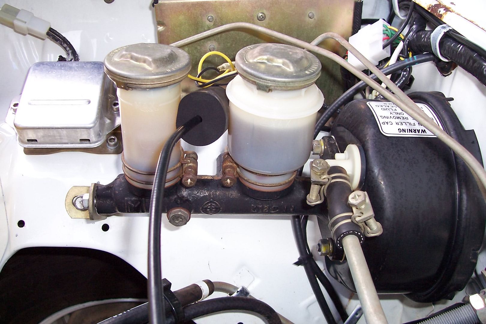

I'm betting you don't have one. Probably Australian model differences, like RH drive, diesel available in 1980 4x4, etc.
Just curious--where does it get the vacuum for your brake booster? A belt driven vacuum pump, or electric one? Diesels engines develope no vacuum normaly. Looks like a very clean, well cared for truck.
Theres a vaccum pump on the back of the alternater.

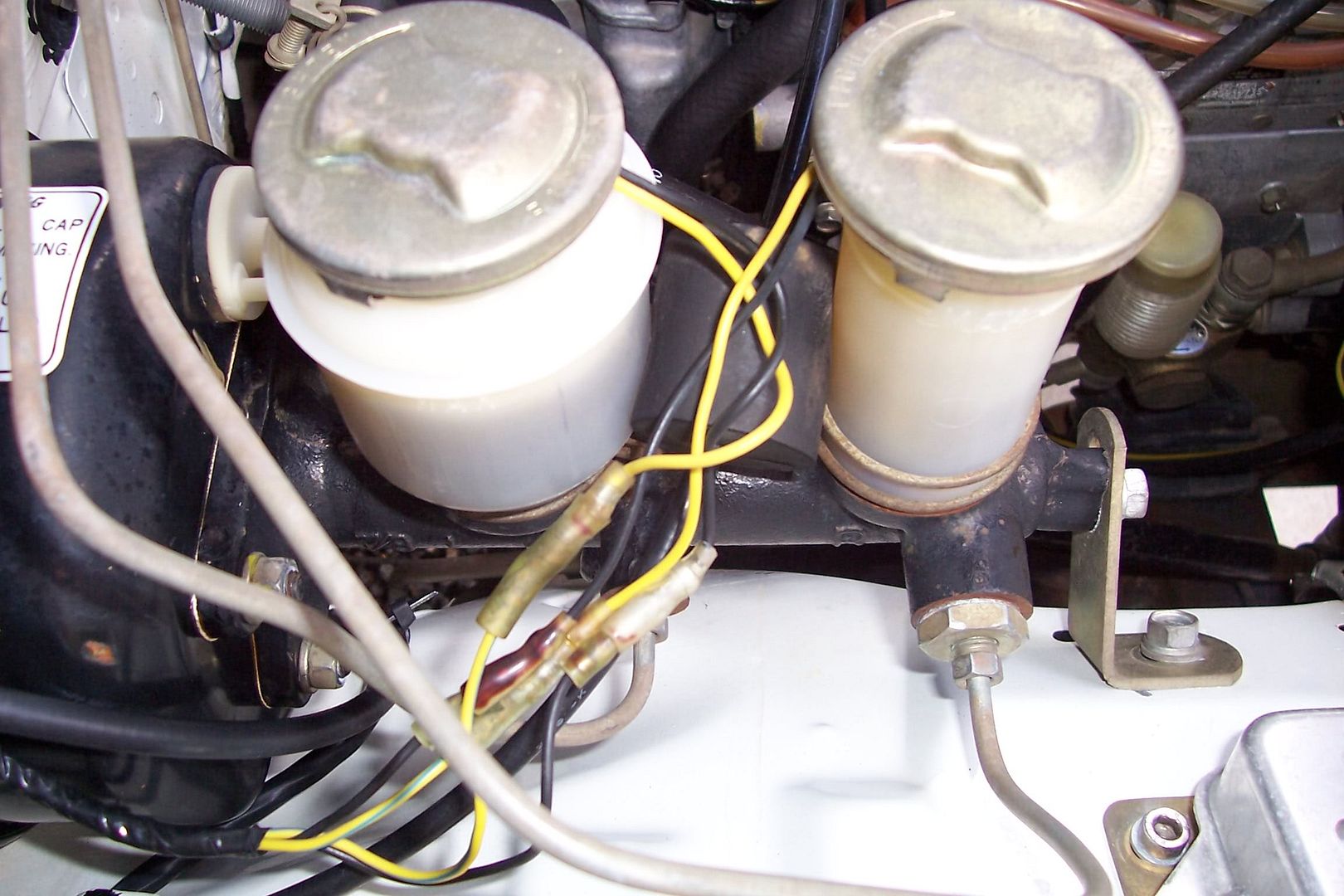

I think it would be safe to say your truck doesn't have a external bias valve for the brakes,it's built into the master cylinder.You notice that your reservoirs are different sizes for front and rear. (usually front brakes have bigger)

Im going to agree with you Mad Dog, i tore down a spare to see what was going on inside. Inside i found two plungers separated in the middle with a spring, looks as tho when you brake, the first plunger moves then when spring is compressed second plunger moves. Applies more fluid to the front than the rear.
