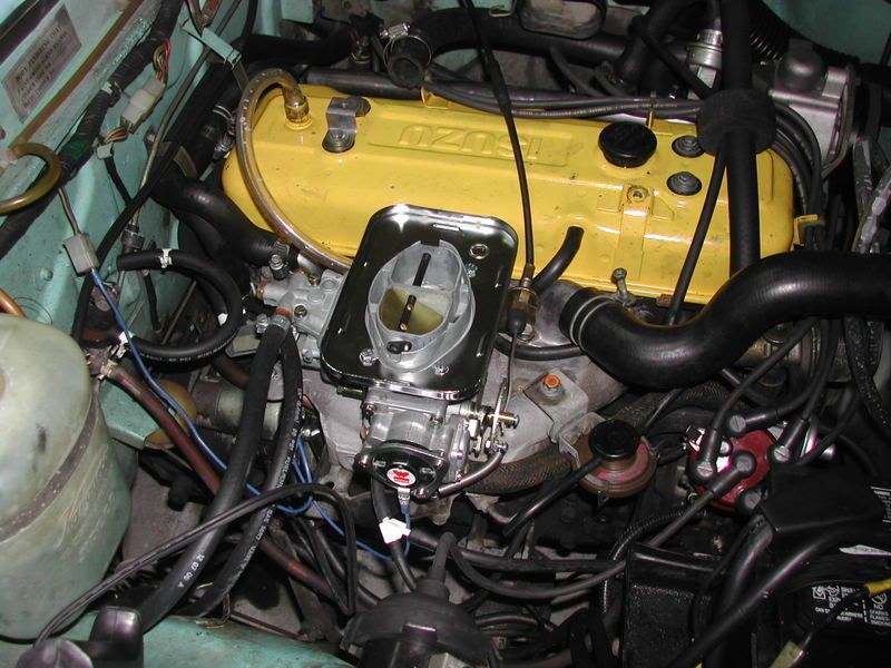

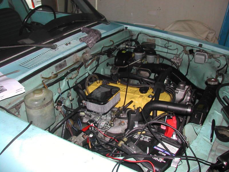

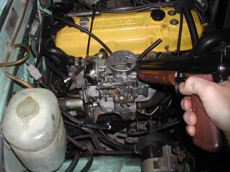

Sooo, I figured out a way to fix this carburetors problems!!!
I gave in, I crumbled

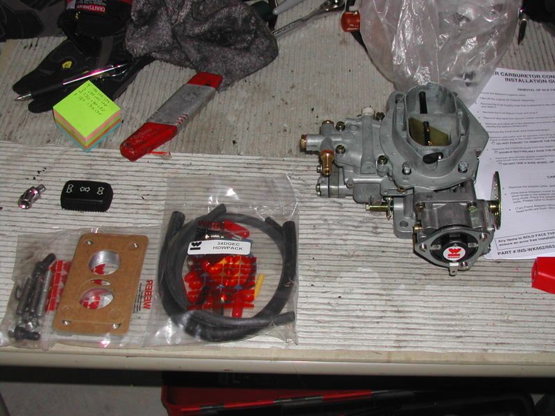

soo I got a
its a 34 DGEC,
Was $30 cheaper
This is what it came with

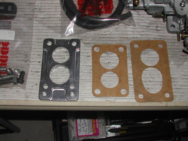

The Adapter one Piece
Doesn't Quite fit

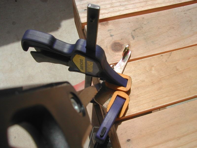

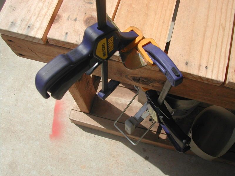

Nothing a little hacksaw won't fix
Hacking
Now it fits
Sitting Pretty

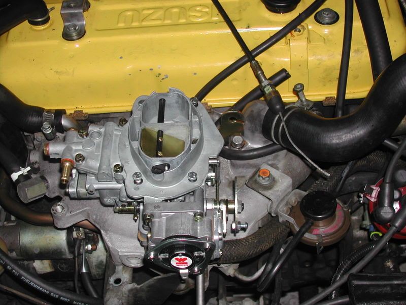

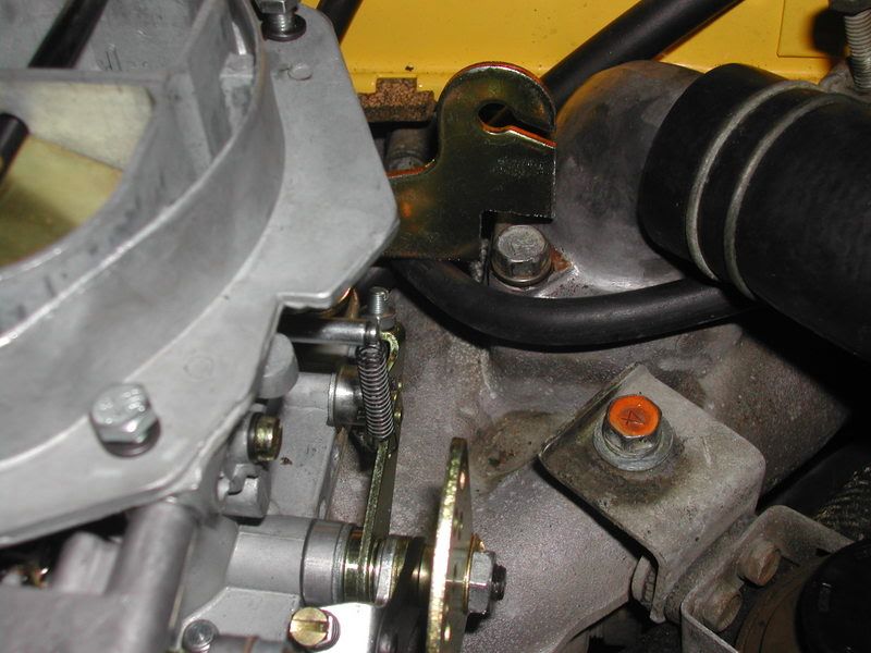

Main Valve kept hitting the adapter on the way down. At first i thought it was just hitting the paper gasket but after tightning it down a little it also hit the aluminum so i got some grinds will i grinded away. Nothing taste better than aluminum shavings on Papa Johns pizza :smt035

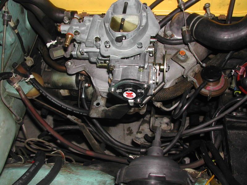

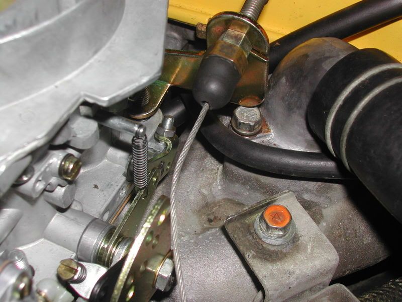

Umm now it fits, i swear its a different pic. I flipped the valve on the right, why, Idk, oh yeah tried using the old linkage but it wasn't quite right.
I think I am an accomplished "make Fit" artist
Started it up, was a little slow on the idle, turn the screws a little after it warmed up and then it settled into a quite roar. Revved beautifully no missing, no rocking back and forth on the engine mounts and no putt putt smoke out of the muffler (except for the first start up)

That's the same kit I put in mine just a few weeks ago, I had the same issue with the vlave hitting the gasket. I was just about to start shaving away on mine, but realized I just needed to nudge the gasket forward(toward the engine) before tightening it all down...for the 4th time :evil:
Didnt have any trouble with the throttle linkage adapter, except figuring out that it was not supposed to mount to the reatainer on top of the valve cover :) ..... I know, RTFM. But who has time to read?
From the picture it looks like you may have a taller than normal bolt in you thermostat.
Congrats

for some reason, even nudgine the adaptor forward and the gasket, the valve was still hitting, enough to make some shavings. I think it will be a lot easier to pass smog with this on than to get the Hitachi to work :)

I'm using the K&N that came with the kit.
Image, Image
Only pics I took so far.

sweet sweet. um the breather up top, is that the same as running the line to the filter? What did you do with the fuel return line thingy, i just plugged it and placed it under the filter so that it looks more stock lol, now i just gotta make it putt and it will pass smog lol. umm any hints to adjusting the fast idle the screw fell off during the install and... NVM it should be soo much easier. On the weber, turning the screws does what it's supposed to. Only thing is they could use some better quality fastners and thread right or wrong. Everything seemed to fit quite loose except the hex screws to hold the adapter down, do you agree?

The breather on the back of the valve cover is temporary it's a oil fill filter thingy I picked up at Autozone , will put in an oil catch resevoir ala ctmandu, later. For now it just keeps from blowing oil all over the place. Didn't want to vent it back into the carb to avoid oily gunky mess. Not sure if this is right, wrong or doesn't matter, but what the heck, it runs. plugged my fuel return line as well.
Only complaint I had was actualy my own fault, while I was deciding wether the stock linkage would work or not I had the Weber linkage nut taken off and the carb sitting on the valve cover, well a few vibrations later I heard the clatter of some small part falling into that region of no return down past the intake to god only knows where. Turns out it was the brass spacer next to the inside of the linkage... glad I keep a wide variety of spare nuts laying around. I looked for at least 30 minutes for that spacer, nada.
I di use a small bit of locktight on the spacer hexes and mounting harware.
